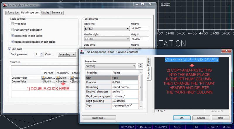

I've been able to "trick" C3D. For example, say you have a Point Number, Northing, and Easting table. Now, in the Table Style editor, go into the "column value" for the Northing column, and copy-and-paste the contents from there into the "column value" for Point Number column. Now change the header of the Point Number column to say "Northing", and delete the Northing column.
The only caveat is that this doesn't seem to work with User Defined Properties, only with the default Cogo Point properties.
Here's an image which might make it a bit clearer.

This smart cheat doesn't seem to work for user defined point properties. In my case, I want to show manually stored numbers. I've followed your description, but the field turns out with just two brackets . I can't understand why Autodesk forces us to show properties!
