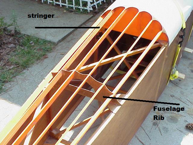

Ok i don't have autocad here at work but here is the basic concept of the stringer/rib design. The ribs are each cut out of balsa and are positioned in order from largest to smallest from the front of the aircraft to the rear. The spacing between the ribs is a fixed dimension. The stringers intersect with each rib and run the entire length of the aircraft. The curves of the aircraft are defined by the way the stringers intersect with the ribs. This image shows almost exactly what i am trying to draw with the exception that the stringers are perfectly straight. Keeping the stringers straight keeps things simple but also makes a very straight, not as modern or aerodynamic fuselage. I am able to draw the ribs and move them to where they resemble the aircraft, but when i try to draw the stringers by making a spline intersecting each rib it does not turn out at all the way it should. the stringers should be about 1/8" thick and 2 inches wide or so and the lengths and curve change from stringer to stringer.fuselage3.jpg Where the stringer intersects each rib, it should be oriented perpendicular to whatever angle the outboard edge of the rib happens to be. not sure if any of this makes sense but im trying. LOL. Thanks again.
I sense some lofting is required.
Also.. Those stringers ARE curved in one direction, and then rotated, because the ribs aren't the same size.
I think the OP's ribs (actually formers) are going to be spaced and sized so that the stringers are not curved, thus achieving a more flat sided, cone shaped, rather than bullet shaped fuselage. The stringers are still going to be rotated, though.

I would suggest laying out the four main stringers (longerons) first, the ones running along the center lines of the top, bottom, left, and right surfaces, and which are on the 90 deg points of each former. In order to get to this stage, I would have to have at least two longetudinal 2D sections of the fuselage, vertical, and horizontal. I would place the longerons first to define the fuselage outline, then place my formers. This would give me accurate height and width for the formers and attachment points for the longerons.

The loft Command works! it looks great! thanks for the tip. I copied all the formers (ribs) and aligned them all to scale, i drew a line from the center of all of them as the path and did the LOFT command and it looks just the way it should. Now for the question, is it possible to look at the newly drawn fuselage in the 3d or 2d wire frame view and convert all the lines that the loft command drew into individual poly lines, arcs, or splines??
