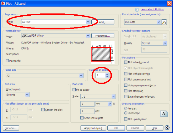

Is it possible to 'grey out' i.e. lockdown all options within the Plot Dialogue Box except for the Page Setup Name, and the Number of Copies ?
My aim is to lockdown all options except 2: user can change the Page Setup Name, and number of copies only.
Is this possible, and if so, any ideas how to go about it ?

oops ! forgot to add picture
No idea if that is possible but (if you are allowed?) you could create your own dialogue box with only those options.

I'm with Dave here though, create your own dialog (or ask someone to do it for you :) ) and perhaps redefine the plot command to your program.

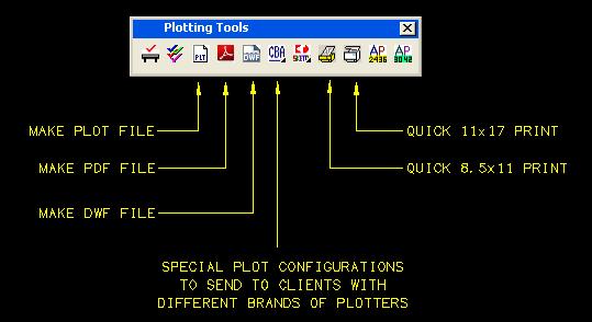

Years ago, I created a plotting menu and placed it on everyones machine. The button call the plotting lisp routines that I have made to control the output (pen settings, plotter configurations, papersize, etc...). Since then, everyone in the company just clicks the button they want, and the print is done. No dialog boxes to step through just to get a quick plot. Now, many of them have forgotten how to plot without them, and even forgot the command plot. :lol:

I would love to be able to create my own dialogue box, but alas my knowledge of how to do so, is this >--
