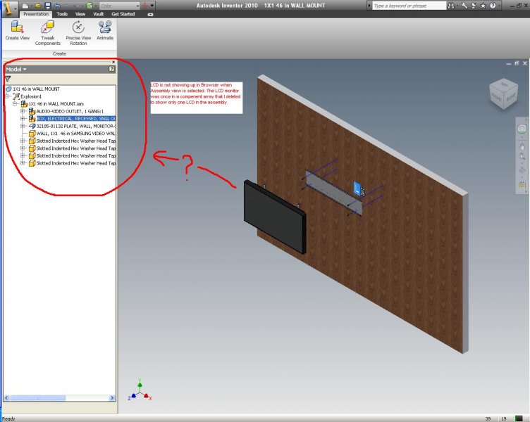

Browser does not list part in ipn fiile.

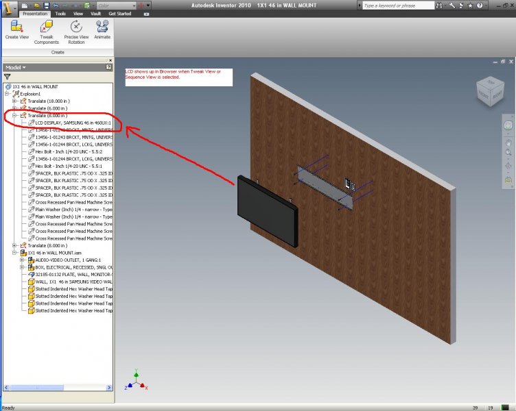

I have a video wall with 3 LCD monitors in an assembled array, and made an assembly drawing using an ipn file to explode the assembly. I then created an assembly drawing with only one monitor, by copying the files, and deleting the array for the single monitor assembly drawing. Now the LCD monitor is not being listed in the Browser when Assembly View is selected, but it shows up in the Tweak and Sequence views. The monitor is at the top level of the assembly heirarchy, and is not hidden in a sub-assembly. I can work with this by switching view types but it is annoying. Has anyone also experienced this, or knows how to correct this? I was thinking it was a software bug having to do with the assembly arrays, but I can't duplicate the problem with test parts and assemblies
