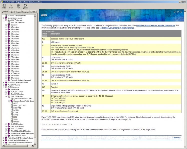

The Buzzard Posted August 16, 2010 Posted August 16, 2010 Look in your Developer Help Section under DXF Reference and then Common Symbol Table Group. There is reference to UCS & VIEW. There is plenty to get you started with regard to the DXF coding. I always use the Developer Help Section as it is always available when I need it. Its a good place to start. Quote

Tharwat Posted August 16, 2010 Author Posted August 16, 2010 Thanks Buzzard, and that's a very big base to start with. Thanks David, and your example is what I looking for to understand in all its ways, specially trans function. Because with this function we could control of our Lisp Routines' Directions, And if you would give more examples with it, it would be very helpful to me. Best Regards, Tharwat Quote
