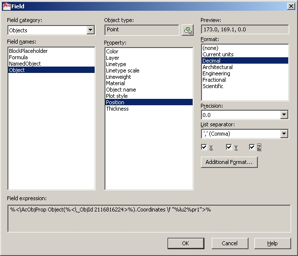

I have a question. I’ve tried to understand your code...
I can’t see where you are referring to block (for picking object id). Before you were using AcDbHatch (for hatch id) but I can’t see this one now... Is it working for any object now and then depends what value you want to show, you are changing (i.e):
(LM:GetObjectID doc (vlax-ename->vla-object e)) ">%).EffectiveName>%"
Please see screenshots below.
So my question is: if I would like to modify it so want to create label with coordinates of selected point, do I have to change only .EffectiveName to .Coordinates?
Sorry for problems, but I want to understand it rather than bother you every single time
Thanks a lot!
Correct, you would just change the property that the field is pointing to. I check that the object is a block in the test statement for the WHILE function :)

and EffectiveName to Coordinates and is creating label with coordinates of selected point :shock:
Now...
as you know there are some 'parameters' in
AcObjProp Object(%%).coordinates \f "%lu2%pr1">%
responsible for units, precision and other stuff...
Is there any way (and by any way I mean simply to understand, edit, change for other type i.e. from %pr to %tu)
to add some options for user to sett, as you did for lisp about hatches on top of this post.

(while (not (<= 0 (setq prec (cond ( (getint "\nSpecify Precision [0/1/2/3/4] <0> : ") ) ( 0 ))) 4))
   (princ "\n** Precision Must be Between 0 and 4 **")
is there any way to show something like graphic below but still get value of selected number so I can imagine that part [0/1/2/3/4] must be edited but how to insert some text here when this is responsible for returning value?
Thanks
I have used the getint function prompt for an integer, hence the function accepts an integer input, not a string. You can quite easily alter the string prompt to display as you posted, but the entry would have still have to be a number.
Lee
