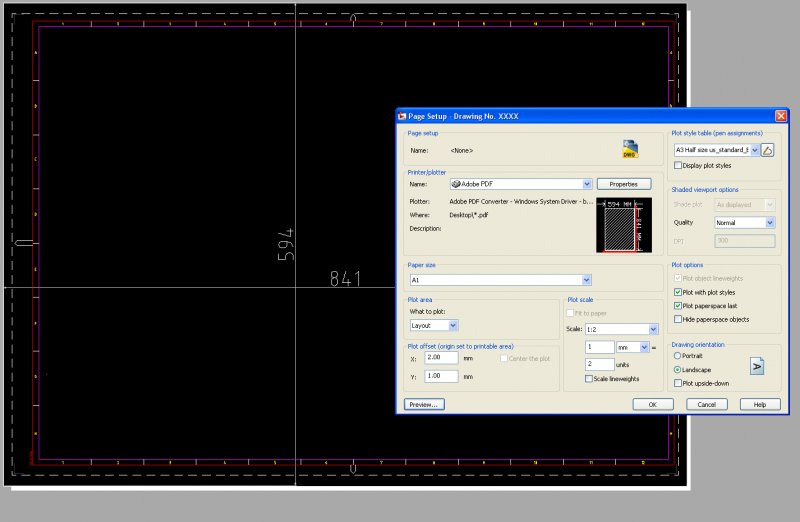

laijumalias Posted August 5, 2010 Posted August 5, 2010 I know that it sounds like a stupid question, but my requirement is to change the real size of the layout after defining a layout is possible or not? More I know that we can change the paper size for the output throught the pagestup manager, but still if you originally define a layout to A1 size its paper size set to A1 and even if you change the paper size after that through page setup manager it will stay as A1, i.e. if you turn on the the paper bakground diplay in options you can read the co-ordinates at the lower left as 0,0 and upper right as 841,594. it will not change. That's what I want to change. Quote

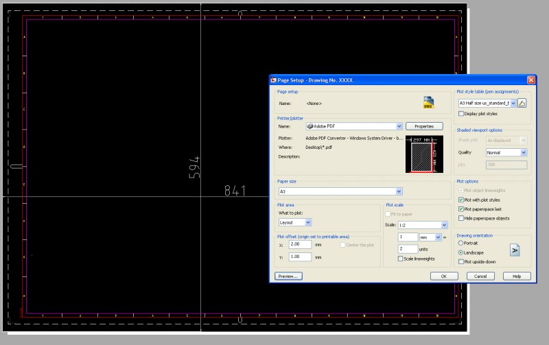

Tiger Posted August 5, 2010 Posted August 5, 2010 ... if you originally define a layout to A1 size its paper size set to A1 and even if you change the paper size after that through page setup manager it will stay as A1,.... No. Not on my machine. When I change from a A1 to a A3 the size most definatly change. [ATTACH]22216[/ATTACH][ATTACH]22215[/ATTACH] Quote

laijumalias Posted August 5, 2010 Author Posted August 5, 2010 thanks to both of you for the reply, It is not working with Suggestion from nukecad as well, i changed the drawing limits but still it shows the paper as A1. see the results from my machine below Quote

RobDraw Posted August 6, 2010 Posted August 6, 2010 nukecad, notice the black rectangle with gray dashed line offset to the inside and the white border on two sides. That is AutoCAD's representation of the paper. It changes in Tiger's but not in laijumalias'. Quote
Tiger Posted August 6, 2010 Posted August 6, 2010 But the paper behind the border is the same size. I am assuming that Laijumalias want what you see in my images, the background in Layout is the actual paper size. I can't for the life of me figure out what else affects the paper size. Quote
