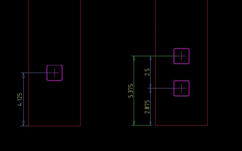

I am making a program that will allow the user to insert either one or two arrow buttons onto a work space. The button being inserted is an arrow, so it can be an up arrow or down arrow depending on what way it is rotated. See attached picture as to placing. This is basically what I want the program to end up doing.
Program Runs
Select Base point
Type of button?? (89, 90, 91, 92 ; colour ; material ; marking)
1 or 2 Arrows? (1 or 2 btn's)
Find drawings in z:\
If drawing does not exist, (princ "\nFile does not exist")
if entered 1 btn, then
Arrow direction (up/down)
If down, rotate btn 180 degree's
insert btn mapcar (0 +4.125 0)
elsif entered 2 btn's, then
insert btn mapar (0 +5.375 0)
insert btn rotate 180 degree's mapcar (0 +2.875 0)
Attached is my starting point code. When run, it promts the user what button style, material, colour, and marking. It stores all the information given into a variable named 'Pressel'. I want it to then locate the file in a specific drive (eg. z:\) and then insert it on
screen where the user selected. I want to expand it to suit my needs but have hit 'THE WALL' and am unsure how to proceed.

I can't test this as I don't have the block, but perhaps it might point you in the right direction:

Two solutions:
1) Add the location of the block as a support path
2) Specify the Directory in the LISP and 'strcat' it to prefix the filename in the first findfile call.
Remember to mark any mods :)

I edited the code provided by Lee Mac and wanted to make an 'if' statement so either his code, or a similar one added to the end could be run. The user would be asked to enter a quantity of parts and it gets stored as 'qty' and then if (= qty 1) then do LeeMac's code else if(= qty 2) do added code at end. Right now it will only do LeeMac's code no matter what. Any help is appreciated.
Kenter
P.s. For the single arrow, I would rather it didn't ask for any direction, rather ask if it is pointing up or down and then insert it in that direction.

Perhaps something like this:

Be sure to prompt for the correct data type, also, remember that the IF statement only take ONE 'then' and ONE 'else' expression, hence you need to wrapping multiple expressions using a progn to be evaluated as ONE progn statement.
