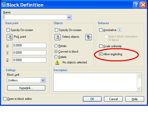

start the Block command to bring up the Block Definition dialog box. Select the block's Name in the pulldown and check the 'Allow exploding' box. Save and you'll be able to explode the block.
erm, it doesnt seem to be in the list? If we click on it, it doesnt seem to come up as a block, and at the top of the properties tab in the drop-down which usually states what sort of item you have selected it says "Line(94)" as if it's selected 94 lines, so it doesnt seem to register as a block! :?

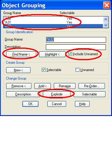

It's probably a Group. Type GROUP at the command line to open the "Object Grouping" dialog. You will be able to Explode the group from there.
If that doesn't work, upload the file.
Pardon my ignorance, but having never used this group tool before I'm struggling to figure out how it works? :/ If I click "Find name" and then click on the group/block it comes up as A56. But I then if I go back into the group dialog all the fields remain blank?

As Cad64 suggested, it's a Group. If you don't want to explode it you can toggle the group selection with Ctrl+H (same as setting Pickstyle - 0=off 1 or 3=on)
If you want to explode the group, you need to select the group name and explode it from the Object Group dialog box.
There are a multiple number of groups on the dwg, I think the ones showing on screen are *A29 and *A32

Thanks for this Ipseifert!! thats done it!
I didnt know how to get it to appear in the list! There are a lot of groups in that!

I removed the 'group' by selecting all the objects, and then clicking "Ungroup" on the Tools dropdown. Now it is just a bunch of lines and things that highlight individually.
