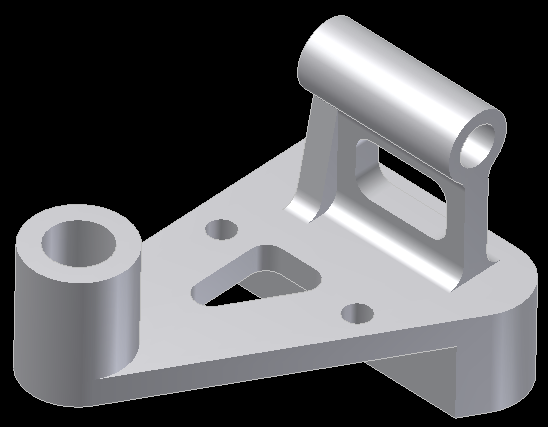

faarax Posted August 2, 2010 Posted August 2, 2010 I need to draw a Bracket using 3D modelling; does anyone has a suggesting for methods or websites with illustrations. Thank you Quote
ReMark Posted August 2, 2010 Posted August 2, 2010 You can draw the bracket in 2D then extrude it. You might want to look into the use of regions. The more detail you provide us with the better we will be able to answer your questions. Are you familiar with reorienting the UCS? Are you familiar with commands such as extrude, sweep, and loft? Are you familiar with the solids editing commands as well? Ex. - Move faces. Are you familiar with commands such as union, subtract and intersect? Quote

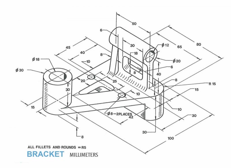

faarax Posted August 4, 2010 Author Posted August 4, 2010 Hi, my colleagus, i am sending the photo. The final drawing I did do not much the original, so I need an idea please. Thank you Quote

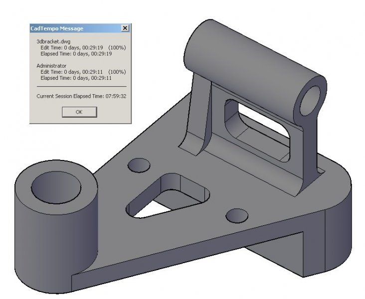

JD Mather Posted August 4, 2010 Posted August 4, 2010 (edited) That looks like an easy beginner part (about 15-20 minutes of work). Attach the dwg of what you have completed so far. It is not possible for someone to figure out where you might be having trouble without the dwg. If you are having trouble drawing a Ø30 circle and presspull a distance of 38, you might want to sign up for an instuctor led class. I stand corrected - 25 minutes from start to completion. The 42 dimension must be 42.5 Edited August 4, 2010 by JD Mather Quote

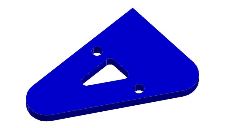

ReMark Posted August 5, 2010 Posted August 5, 2010 This is what I suggest you attempt to do first. Create the 2D geometry. When finished use the Region command and window everything you just drew. Next, use the Subtract command and subtract the interior triangle and the two holes. Finally, use the Press/Pull command to pull the object to the required height of "8". Done. Quote

Patrick Hughes Posted August 5, 2010 Posted August 5, 2010 Curse you JD Mather You beat me by a few minutes. In my defense this was done on release 14 (old technology). I didn't seem to have a problem with the 42 dim. Can you explain why the suggestion of 42.5? I think a beginner would be at least twice that time. Quote

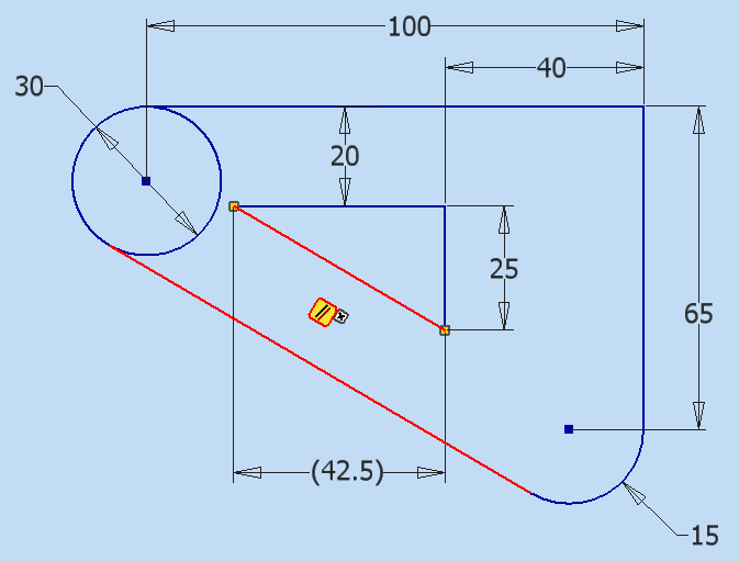

JD Mather Posted August 5, 2010 Posted August 5, 2010 (edited) Patrick Hughes said: I didn't seem to have a problem with the 42 dim. Can you explain why the suggestion of 42.5? I'll have to go back and check my geometry to make sure that I didn't make a mistake, but I assumed the design intent was for the angle to be parallel to the tangent line on the outside of the part. Even if I am right about the design intent and my claim that would make it 42.5, I guess you could argue that dimensions overrule. Yep, a check in a modern parametric program shows that if those lines are parallel the reference dimension is 42.5 This is what I really like about a history based model - if someone makes a mistake in logic, geometry or trigonometry the modeling history tree can be interrogated to see where they went wrong. Without a history tree mistakes might not be discovered or understood why they happened. With a history you could go back to the designer and ask what the design intent is. Years later it migh be possible to figure out even if the original designer is no longer avialable. Notice that the 42 (or 42.5) dimension is not even needed. A modern program indicates this as a reference dimension - (dimension in brackets). Beginners often have trouble understanding what dimensions are needed to fullly define a geometric shape. Next-generation CAD products tell you when you don't have enough or have too many dimensions. Edited August 6, 2010 by JD Mather Quote

Patrick Hughes Posted August 6, 2010 Posted August 6, 2010 JD Mather said: Notice that the 42 (or 42.5) dimension is not even needed. A modern program indicates this as a reference dimension - (dimension in brackets). Beginners often have trouble understanding what dimensions are needed to fullly define a geometric shape. Next-generation CAD products tell you when you don't have enough or have too many dimensions. Thanks for that JD. It just may be that it was rounded down as there aren't any decimal dimensions. Quote
