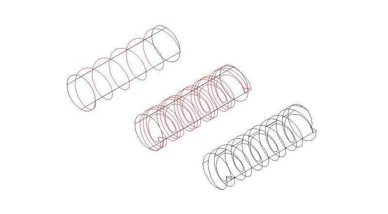

Alex At Altec Posted August 5, 2010 Author Posted August 5, 2010 Hello ReMArk, I have had ago generating a thread from scratch, but I am missing a stage. I have generated a thread, M8 x 1.0mm. Then I added an extended diameter of 8 by 30 mm long. I then substracted the thread from the cyclinder, but not nothing happened. I expected to see a thread cut into the 8mm cyclinder. Any ideas? Alex Quote
Alex At Altec Posted August 5, 2010 Author Posted August 5, 2010 Hi JD, Thank you for the file. I will let you know how I get on. Alex Quote

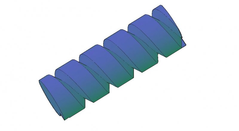

ReMark Posted August 5, 2010 Posted August 5, 2010 Nothing happened? That's odd. Perhaps your helix had a larger diameter than was required. Look at this 2D wireframe image. The helix wraps the cylinder. Both have the same radius. The "cutting edge" (a triangle) is swept along the path of the helix then the solid that is created is subtracted from the cylinder This is the result of that subtraction. Quote
