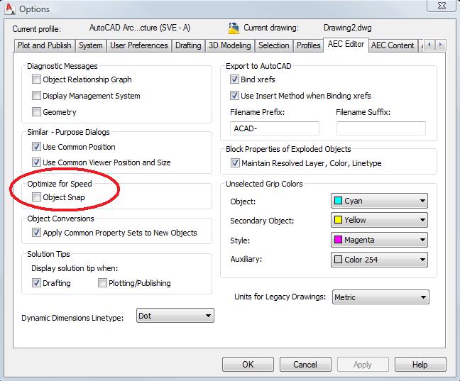

I do not know about MEP, but in Architecture there is a setting for this in OPTIONS under AEC Editor.
From help section: "Under Optimize for Speed, select Object Snap to limit certain display representations to respond only to the Node and Insert object snaps.
This setting affects stair, railing, space boundary, multi-view block, masking block, slice, and clip volume result (building section) objects"
So what it says is that If the box is ticked, it doesnt snap to anything else then the insert point of ex. multi-view block.
//Tobias
