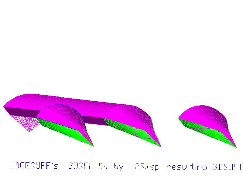

scj Posted August 4, 2010 Posted August 4, 2010 Here my suggestion using meshes: First make a modell consisting of EDGESURF's. (To get 4-side-boundes meshes you have to break the arcs.) Explode the meshes to get FACES and use F2S.lsp by Bill Gillis to get the resulting 3DSOLID. Higher values of SURFTAB1 and SURFTAB2 will give better meshes but make the file bigger... Regards Jochen PS.: The DWG has about 500kb - in case of interest pleas contact me via http://www.black-cad.de Quote
JD Mather Posted August 4, 2010 Posted August 4, 2010 I would not even begin to suggest using Meshes. Looks like I'm going to have to find the time today to show how it should be done. Quote
JD Mather Posted August 5, 2010 Posted August 5, 2010 Issue the acisin command and import the attached file. You might want to go through the tutorials in my signature and concentrate on Loft and Slice with surface option. Shape to Solid-Forum Help.zip Quote
