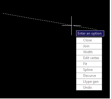

hcyc Posted July 31, 2010 Share Posted July 31, 2010 Hi, Having Autocad2009, when i double click a polyline for pedit command, the options window that includes "Close/Join/Width/Edit vertex/Fit/Spline/Decurve/Ltypegen/Undo" does not pop up although they are asked in command window. Also same thing occurs for mvsetup command. I cannot enter the align and then rotate option by mouse click since the option window does not pop up. any solutions will be really appreciated. thanks in advance Quote Link to comment Share on other sites More sharing options...
ReMark Posted August 1, 2010 Share Posted August 1, 2010 Could this have anything to do with Quick Properties? Do you use this feature? Quote Link to comment Share on other sites More sharing options...
hcyc Posted August 1, 2010 Author Share Posted August 1, 2010 pictures are in attachment pedit.jpg : options menu for pedit command mvsetup.jpg : options menu for mvsetup command Quote Link to comment Share on other sites More sharing options...
lpseifert Posted August 1, 2010 Share Posted August 1, 2010 Be sure Dynprompt=1 Quote Link to comment Share on other sites More sharing options...
hcyc Posted August 2, 2010 Author Share Posted August 2, 2010 Ipseifert's solution fixed the issue, thanks very much for answers. Quote Link to comment Share on other sites More sharing options...
