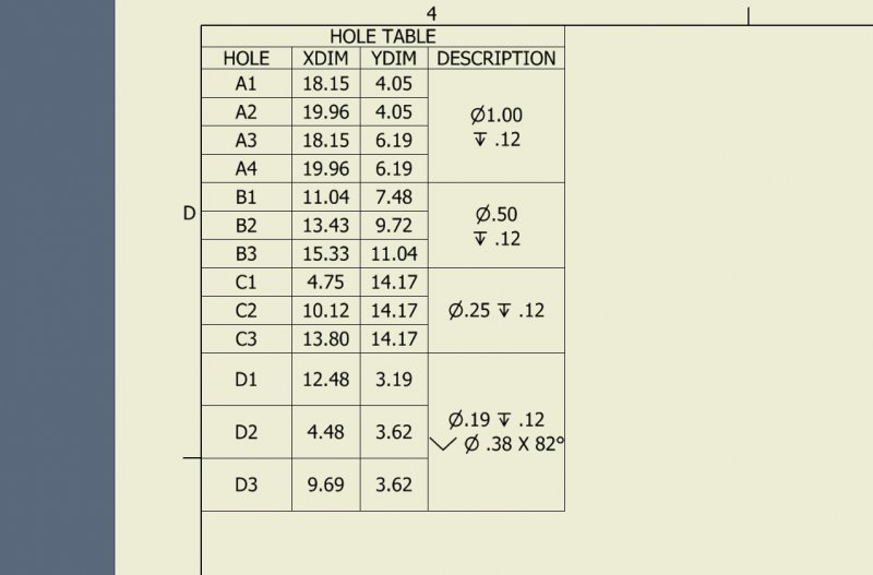

gargoyle27 Posted July 29, 2010 Share Posted July 29, 2010 ok, so i want to change some specific things about a hole table i'm trying to make in the C labeled holes, i want the rows to be only one row high, it defaults to two because of the two height description i think, how do i change this? also, i wanted to change the hole names, but then sort it by the name (as you would for a part list with ballons) but how do i sort it again once you've changed the name? i just regenerated this table to get it numbered the way i wanted i had some other problems, but i figured them out here's a picture so you know what i'm talking about Quote Link to comment Share on other sites More sharing options...

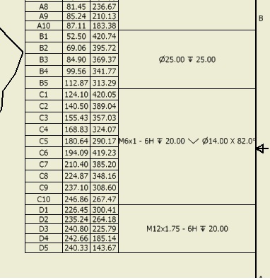

ecshclark Posted August 3, 2010 Share Posted August 3, 2010 Double click the text that has two lines - M6x1.... - You should get a Edit Hole Note dialog box. Uncheck the Use Default, then edit the Note Format to be one line of text instead using two lines. Hit OK, then on the table drag the row line that is double spaced until it is the same heigth as the other single spaced rows. I don't know how to make the table default to single lines. Quote Link to comment Share on other sites More sharing options...
gargoyle27 Posted August 3, 2010 Author Share Posted August 3, 2010 i tried that, tho it does work, then that coloumn is crazy wide and it looks like crap, isn't there a way to make the hole rows them selves shorter? it won't let you drag them smaller eventho theres nothing stopping it Quote Link to comment Share on other sites More sharing options...
ecshclark Posted August 3, 2010 Share Posted August 3, 2010 Seems let me drag the row & column lines. If you want it shorter you would have to change the text height and width in the table editor Quote Link to comment Share on other sites More sharing options...
gargoyle27 Posted August 3, 2010 Author Share Posted August 3, 2010 i want the description to be two lines (it's too long to be one line and look nice, plus it's a waste of space) but the xdim and ydim etc. to be only one line Quote Link to comment Share on other sites More sharing options...
gargoyle27 Posted August 3, 2010 Author Share Posted August 3, 2010 here's what i have now, but i don't think it looks very good and it wastes tonnes of space Quote Link to comment Share on other sites More sharing options...
ecshclark Posted August 3, 2010 Share Posted August 3, 2010 Like this? If so, just double click on the descriptions that are long, and edit with a return between the text to drop it to a second line. Then drag the column or row lines where you want them. Quote Link to comment Share on other sites More sharing options...
ecshclark Posted August 3, 2010 Share Posted August 3, 2010 I see you're on 2009 and I'm on 2010. Quote Link to comment Share on other sites More sharing options...
gargoyle27 Posted August 3, 2010 Author Share Posted August 3, 2010 yeah, that might be whats happening, the first thing i tried was what you said, but it won't let me make the rows any shorter than double spaced regardless of how tall the text actually is in that row, it keeps it double because the description is double, eventho those cells are merged, so annoying, so does that mean theres no way? Quote Link to comment Share on other sites More sharing options...
