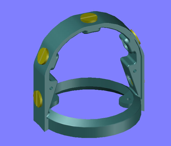

What are you trying to do? What is your part? My guess is that it is some sort of glass or plastic globe. Is that correct? What is the thickness?
It is a cast aluminum cover for this, it is .125 in. thick. after thickening the part, your right it is not good enough and needs more work. I get a bad seam where the two surface's meet and if I join the two surfaces before thickening it won't thicken.
How is your new part supposed to match that part? That part has flats and fillets on the curve. Is the cover supposed to match or will it have overhang or underhang at the flats on the curve?
I suspect rather than thickening a surface to a solid that a better approach is going to be Shell a solid, but since I don't know where you are going with this.....
