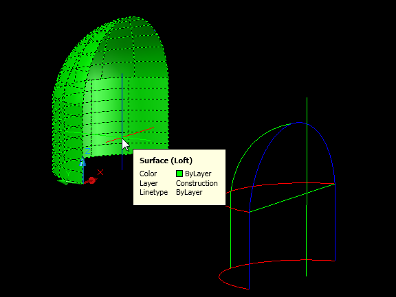

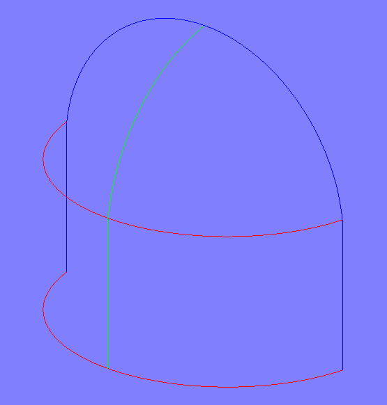

Barn Light Posted July 28, 2010 Posted July 28, 2010 Hello all, I am useing AutoCad 2011, and having trouble createing a surface out of the lines shown here. The three colors represent three different shapes. I have tried all of the commands in mesh surface but I must not be doing something right. What command should I be useing? Quote

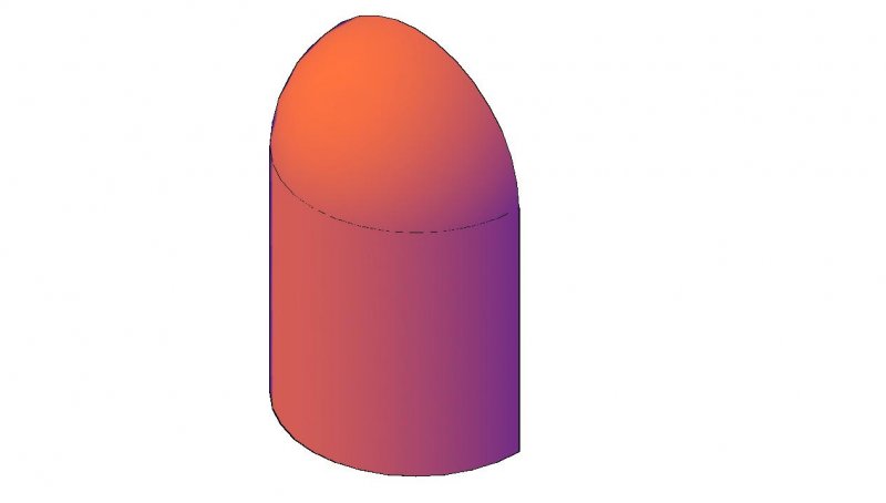

ReMark Posted July 28, 2010 Posted July 28, 2010 Not sure why you would need all three shapes as you call them. I used a single profile swept along an arc to create this. Hmmmm....seems I have a surface and not a mesh. Sorry. Back to the drawing board for me! Quote

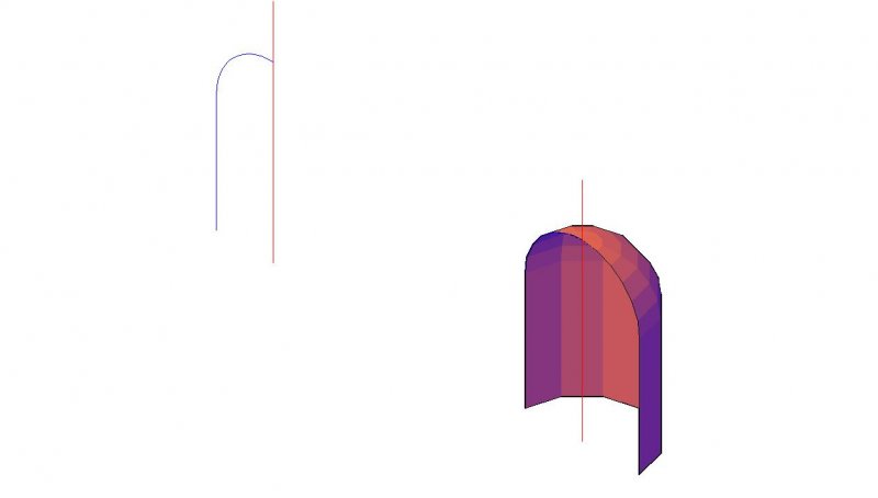

ReMark Posted July 28, 2010 Posted July 28, 2010 Barn Light said: Is there really a need to be sarcastic? Say what? I'm not sure where that came from. Anyway...here is the solution to the problem. You need to start with a profile and a centerline. Then all you need to do is use REVSURF to create the mesh. Like this: Quote
ReMark Posted July 28, 2010 Posted July 28, 2010 REVSURF can be found on the Mesh tab > Primitives panel (far left hand side of your Ribbon). There are four buttons for Revsurf, Edgesurf, Rulesurf and Tabsurf. Is everybody happy now? Quote
Barn Light Posted July 28, 2010 Author Posted July 28, 2010 I tried that, that is not the shape I am looking for. The green arc (shape as I call them) is different from the blue ones, so a revolved profile of the blue profile does not match the green profile. Quote

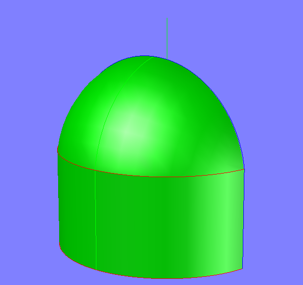

Barn Light Posted July 28, 2010 Author Posted July 28, 2010 I got it, well something that will work anyway, using the sweep comand. Thank you for your help though. Quote
kencaz Posted July 28, 2010 Posted July 28, 2010 I think Loft will give you a more accurate surface... Quote
Barn Light Posted July 28, 2010 Author Posted July 28, 2010 No, like I said it will work for what I'm doing. I just needed a surface, I guess I'm getting the termenology mixed up surface mesh????? I used two sweeps, a blue vertical along the bottom red and the top red along the center green. the second one I had to trim. Quote

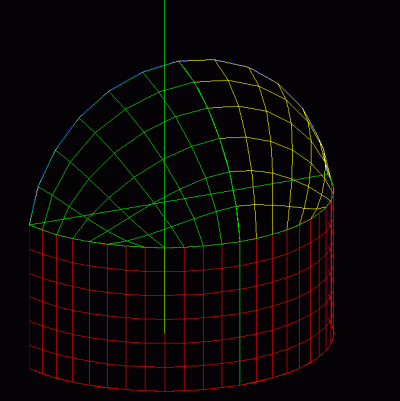

David Bethel Posted July 29, 2010 Posted July 29, 2010 It can be made with 3 meshes ( EDGESURF ) You would need to break certain edge lines in order to 4 connected edges. -David MESHPROF.DWGFetching info... Quote
