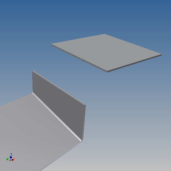

Hopinc Posted July 30, 2010 Posted July 30, 2010 Yes, I can answer this one. "Bend" is used to create a bend between two sheet metal faces that are unconnected, whereas fold operates on a sketch line on a single part. If you click on the Bend command and then the question mark at the bottom left it will take you an explanation. Click Procedure at the top of the page and then select "Create a sheet metal bend," and finally the "Show Me how to create a bend" animated sequence. In the attached images "fold" was used to on the left hand part, and "bend" between the two surfaces. Regards. Dave Quote

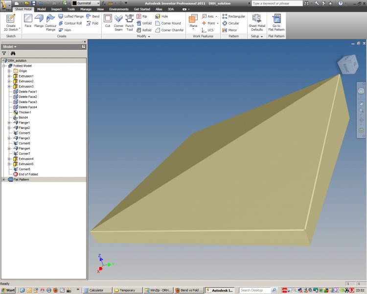

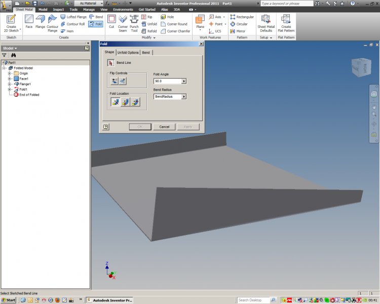

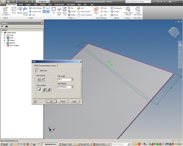

Hopinc Posted December 3, 2010 Posted December 3, 2010 (edited) Hi, If I am understanding your question correctly, it is a relatively simple matter to make a tapered flange. At least it is 2010 and 2011. Sorry, but I don't have 2008 so I don't know if it is any different in this respect. Presuming 2008 has the same sheet metal facilities, all you have to do is sketch a line on the panel surface corresponding to where you want your tapered flange to be (see the example in image 1) and then select "fold" from the sheet metal menu. Next pick the line, and the pop down menu that appears will give you options such as angle, direction, inside, outside or centre of bend and bend radius. Image 2 shows the result. If this is not what you want please attach a sketch of the shape you are trying to make. Regards, Dave Edited December 3, 2010 by Hopinc Quote

sodapop808 Posted December 10, 2010 Posted December 10, 2010 I am now on 2011. I have tried a couple of different ways of getting to the end result, all of which I have failed at. I have started with a primitive solid, then used shell, then ripped corner seams, then try adding bends and the part fails at the face break. I have tried using sheet metal environment, and I get the face to break properly by using lofted flange, but can't add a flange that returns 90 degrees while the sides are parrallel with the corners. I am sure that I have tried to run before I could walk, but I guess that how I roll. I will attach 3 files. One is the primitive solid shape (Faceted AL Primitive.ipt), one is the extent of my sheet metal attempt which is the closest I have come(Faceted AL 02.ipt), and one is my shell attempt (Faceted AL From Shell). AL Panels.zipFetching info... Quote
Hopinc Posted December 11, 2010 Posted December 11, 2010 (edited) Hello sodapop808, Please find attached herewith a solution to your problem. I tried to convert from a solid to sheet metal without success, but the answer was a combination of both part modelling and sheet metal. It worked just fine without any problems whatsoever. I had anticipated a struggle, but in the end it didn't take long at all. Sometimes you just have to think outside of the box. Regards, Dave DRH_solution.zipFetching info... Edited December 12, 2010 by Hopinc Quote
sodapop808 Posted December 13, 2010 Posted December 13, 2010 A very talented effort indeed! However, because some of the sketches are unconstrained, the model seems to have problems when I try to update any of the dimensions via Parameters Manager. This part will be variable in both height and width as well as the "tall" corner and "short" corners. I too was able to get close to your results this way. Your corners,however, are definetly steering me in the right direction. I will try to work with your model to see if I can constrain it and make it update. Thanks for your input!! Quote

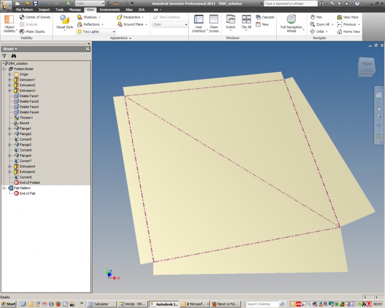

JD Mather Posted December 17, 2010 Posted December 17, 2010 I guess the hard part I'm having trouble understanding is you attached 3 different files that don't seem to be heading in the same direction. Here is what I seem to gather is sort of common geometry between the 3 files. This portion was relatively trivial - you will have to continue on with the geometry (pull down the EOP marker in the browser) for additional suggestions I might be able to provide on finishing the part. This example was done in edu version - so delete after examining the technique. I think you will find it significantly easier than the previous solution that was attached here. Tray-jd.zipFetching info... Quote
Hopinc Posted December 17, 2010 Posted December 17, 2010 Nice One, JD! I had tried that method myself. It did not work for me because I did not delete the corner surfaces, and the corners would not work out. That is a good trick I will remember that. Regards, Dave Quote
sodapop808 Posted December 17, 2010 Posted December 17, 2010 OK. Wow. I can't beleive how overly complicated my model was compared to yours! OK. You filleted the corners first. I'll make note of that. I have never tried it that way. I shelled it, then tried to rip corners and make bends. Then you did a delete face and thicken instead of a shell. Is there a reason for this? I would have never thought that way. I am going to try and do a model myself this way now. Thank you very much for such an elegant solution. Although you think it a simple part (and yours is!), I think it is because you are a Jedi master, and the solution was there from the beginning. Quote
