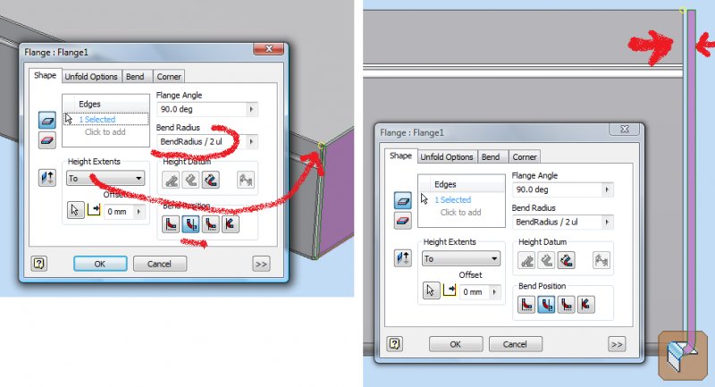

JD Mather Posted August 9, 2010 Share Posted August 9, 2010 Now create a Flange on the back edge as shown (I always pick the outer edge for consistency). Your dialog box in earlier release might look a bit different. We could change the Bend radius rather than keep dividing by 2, but for now lets leave the defaults alone and do the division. I am trying to do this in a way that would work in 2008, we will have to adjust the Contoured Flange1 distance, but we can hold that off till later. Today starts my busy time of the year so my instructions will be posted only as I have time. Quote Link to comment Share on other sites More sharing options...

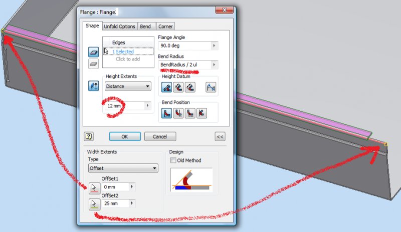

JD Mather Posted August 9, 2010 Share Posted August 9, 2010 The next step is a little tricky, but for the corner we need to extend the flanges. I pick the back edge first. You can use whatever corner style you want - weld or tear results in a tight corner. Repeat for other side. Quote Link to comment Share on other sites More sharing options...

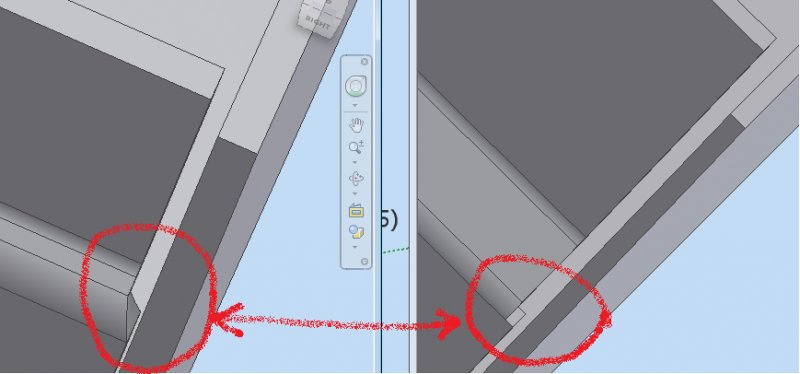

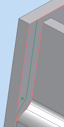

JD Mather Posted August 10, 2010 Share Posted August 10, 2010 i have made the necessary corrections ... Did you attach the updated file - doesn't look any different to me? I'll assume you do have it corrected. I am trying to use techniques that would work in 2008. Not sure if this is a limitation of 2008 or something you have done differently - but notice the transition of this bend in my model vs your model. (actually if I were doing entirely with 2011 techniques there is even a better way than I am using for these tutorials) Quote Link to comment Share on other sites More sharing options...

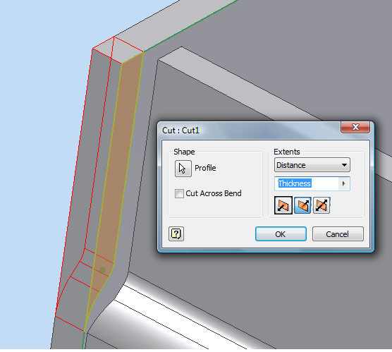

JD Mather Posted August 10, 2010 Share Posted August 10, 2010 Now Cut the corner of the back flange. (Do not repeat or mirror at this time.) Quote Link to comment Share on other sites More sharing options...

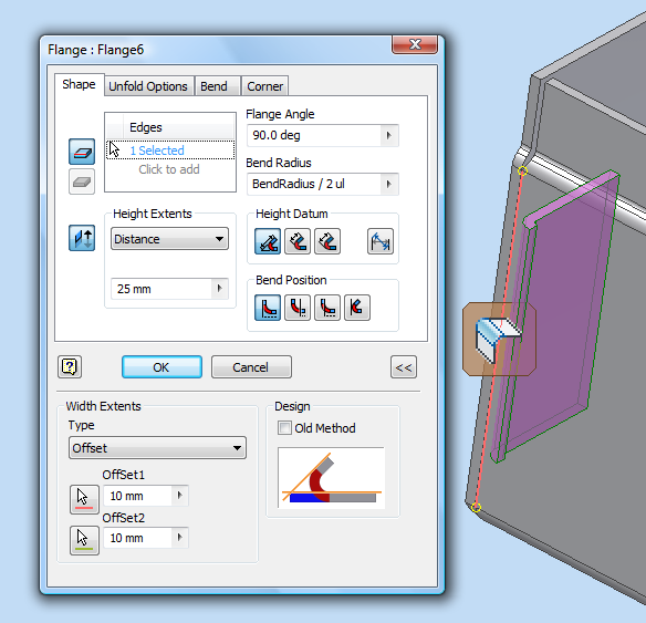

JD Mather Posted August 10, 2010 Share Posted August 10, 2010 Create a Flange selecting the edge shown. Expand the dialog box and set offset distances. Now mirror both the flange we just created and the cut to the other side using the YZ plane as the mirror plane. Quote Link to comment Share on other sites More sharing options...
JD Mather Posted August 10, 2010 Share Posted August 10, 2010 Now create one of the top flanges as shown with an offset on only one end. Repeat on other side. (Don't mirror, we could have created one entire side and then mirrored Body, but since we didn't.....) Quote Link to comment Share on other sites More sharing options...

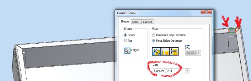

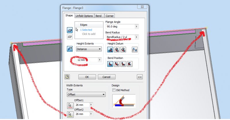

JD Mather Posted August 10, 2010 Share Posted August 10, 2010 Create the back top flange with an offset on each side. Where did I come up with the number 26? This number is somewhat irrelevant as long as it is greater than the side flanges. I want to be able to edit the side flange distances without causing an intersection. Often times in a case like this where I know a range of similar parts will be made I will initially make that flange very short - say 10mm. The next step will take care of the true length. Quote Link to comment Share on other sites More sharing options...

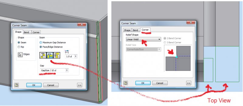

JD Mather Posted August 10, 2010 Share Posted August 10, 2010 Now add the mitered Corner Seams. (I have already done left side in attached image.) There is way to create a more aesthetically pleasing corner in 2011, but it takes a bit of trickery, and since you don't have 2011.... When I come back we will look at the cooling vent cuts. Our goal will be to use Feature Patterns rather than Sketch Patterns. Quote Link to comment Share on other sites More sharing options...
