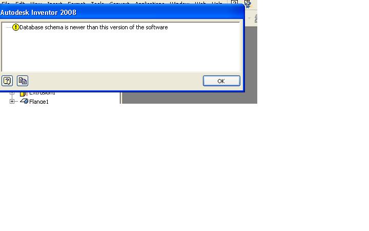

nikhil Posted August 6, 2010 Author Share Posted August 6, 2010 this is the error i am getting....even after installing the feature recognition...i"ll try to restart my p.c an see if it works.... Quote Link to comment Share on other sites More sharing options...

Hopinc Posted August 6, 2010 Share Posted August 6, 2010 OK, then I believe that this message is telling you is that the file you are trying to open was created with a newer version of Inventor. It is sad, but true, that a later version of Inventor will not write backwards compatible files, unlike AutoCAD. Regards. Dave Quote Link to comment Share on other sites More sharing options...
nikhil Posted August 6, 2010 Author Share Posted August 6, 2010 ya exactly...i guess this is what it means,will this file work in autocad 2010,bcos thats installed on my system so i can use it from there also Quote Link to comment Share on other sites More sharing options...
Hopinc Posted August 6, 2010 Share Posted August 6, 2010 Hang on! - so you are trying to open an AutoCAD 2010 file within Iventor 2008? That simply won't work! What are you hoping to achieve by doing this anyway? You cannot edit the AutoCAD drawing file within Inventor, if you opened an AutoCAD file within Inventor you can only really measure, cut and paste, and a few other minor things. You might as well open AutoCAD itself and then cut and paste from that into the Inventor sketcher. That way you will not have a problem with them being different date versions. Dave Quote Link to comment Share on other sites More sharing options...
nikhil Posted August 6, 2010 Author Share Posted August 6, 2010 no u got me wrong.....what i am saying is will this inventor file that u sent me will open in autocad 2010... and not vice versa can i open inventor files in autocad....this is what i am asking and not the other way round Quote Link to comment Share on other sites More sharing options...
Hopinc Posted August 6, 2010 Share Posted August 6, 2010 (edited) Firstly, you cannot open an Inventor .ipt (part file) or .iam (assembly) file in AutoCAD. Nor can you run an add-on program intended for Inventor and expect it to load into AutoCAD. There would be no point doing that anyway as it is intended to recognise and create features based on IGES, SAT or STEP files. FYI - you can create AutoCAD standard drawings of components and assemblies within Inventor (various versions, e.g. 2007) which you will be able to open with your copy of AutoCAD. Be careful though, any changes made to the AutoCAD drawing will not be automatically reflected in your solid models. I thought you had Inventor 2008 running? If you have all you have to do is execute the "feature recognition" program and it will install automatically. Dave Edited August 6, 2010 by Hopinc Quote Link to comment Share on other sites More sharing options...
