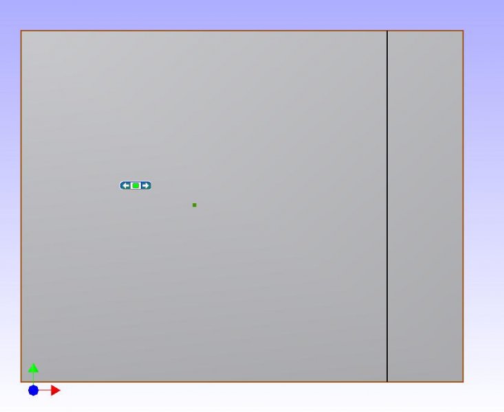

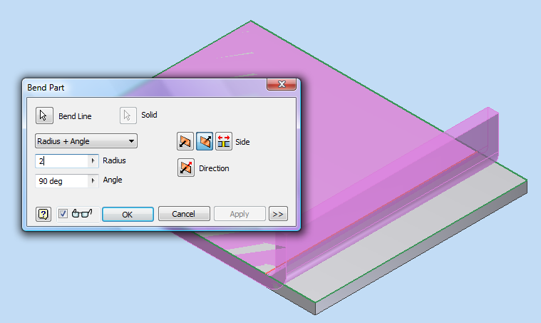

JD Mather Posted July 27, 2010 Share Posted July 27, 2010 First thing I noticed is that there are no dimensions on Sketch1? i dont want to use flange since it leaves the corners.... This satement doesn't make sense to me. The corners are going to be the same whether you use Fold or Contoured Flange. Model it any way you know how and then I'll show you how it should have been done. Is this a sheet metal part? If so, why are you using Extrude? Since you are not using the latest release you should always state what release you are using in every thread (add it to your signature or avitar) In later releases you could use Bend Part on that black line, but not sure that was avialable in 2008. Quote Link to comment Share on other sites More sharing options...
nikhil Posted July 28, 2010 Author Share Posted July 28, 2010 thanks for replying JD...well i am using 2008 and there is a bend option in 2008.it is a sheet metal part...but what is better than extrude,shall i be using face command.....when we use bend the corners are round and i want it to be box like...how do i get it....i might be shifting to 2010 version soon Quote Link to comment Share on other sites More sharing options...
JD Mather Posted July 28, 2010 Share Posted July 28, 2010 I doubt there is a Bend Part option in 2008, are you sure it isn't Fold? How will your part be manufactured? Bent or Folded parts have rounded bends or folds. Can you post a screen capture of a similar part an AutoCAD 2D drawing? Quote Link to comment Share on other sites More sharing options...

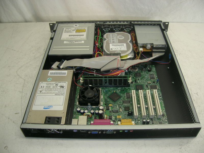

nikhil Posted July 29, 2010 Author Share Posted July 29, 2010 this is what i am gona make...not the internal parts and circuit but just the outer box or covering Quote Link to comment Share on other sites More sharing options...
JD Mather Posted July 29, 2010 Share Posted July 29, 2010 Looks like a straight-forward sheet metal part, shouldn't be particularly difficult. How familiar are you with the standard tools in Inventor (not sheet metal)? You should be able to model it with the standard tools - then I could show you how to model it with sheet metal tools. Do the best you can and then attach the file here. Forget about folding (bending) from flat to as-folded for now. Model it as folded - like the finished part. (I very very rarely fold from flat - it is much easier to model finished geometry and there are other advantages as well.) Quote Link to comment Share on other sites More sharing options...

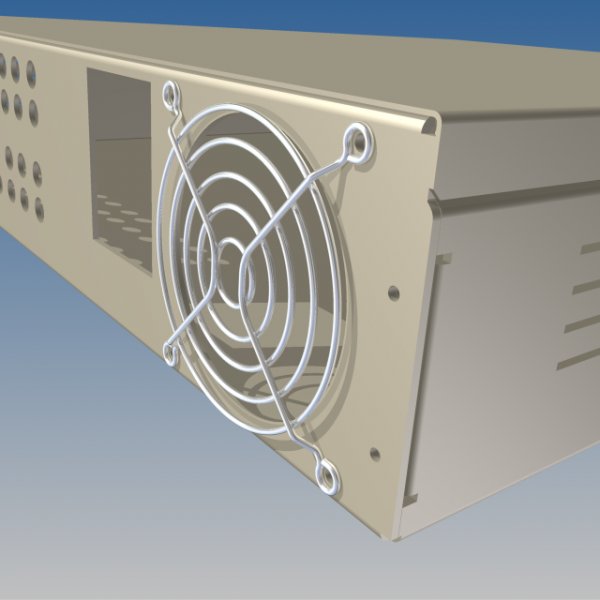

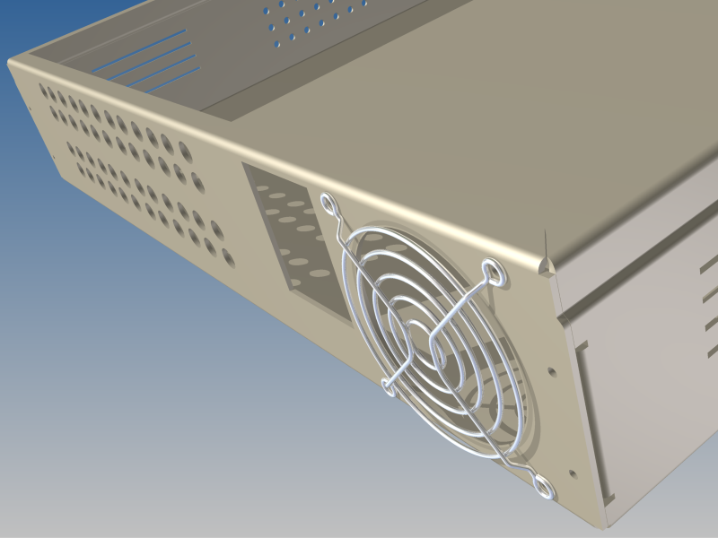

Hopinc Posted August 4, 2010 Share Posted August 4, 2010 (edited) Hi NikHil, Unfortunately I must agree with JD's assessment of your model - sorry, I know it's hard to be told that. However, as a first stab you have obviously picked up some of the basics. If you intend doing more of this work might I suggest that you find some professional training. This will save you hours and hours of playing around by yourself, and give you a much better foundation to progress from. For some reason your model came into my system at 1/10th scale. You are obviously wanting to create a 2U 19" rack mounting chassis so I just scaled everything up to 456.0mm W x 503.0mm D x 85mm H. I got the impression from your posts that you might be getting a bit desperate for a result so I created a chassis for you this morning as I had some spare time. I pretty much dispensed with your model and started again, but I did scale up and re-use the sketches of the holes on the sides. I created half a chassis with the sides holes and mirrored it about centre. Then I cut the holes in the rear. As far as corner treatments go, the number of variations that could be applied to this chassis is almost endless. I chose one that was neat, with no nasty sharp corners. It requires the lid to be a drop on "U" form shape. I personally would not have chosen to do it this way if I had not been following your design intent. This way of working requires too many dimensions to be held. It would be easier and cheaper to have flush sides and a simple flat lid. The PCB mounting holes have been omitted, but they will only take moments to add. As far as the fan cut-out design goes I am not quite sure what you intended to do as yours would have dropped in bits, so I took the route of using a proprietary guard. This has a great advantage in allowing the best air flow possible. I have attached herewith a picture and the chassis file. Please do not feel any obligation to use it, if you want to create your own with JD's guidance that's OK. Regards. Dave chassis_new.zip Edited August 4, 2010 by Hopinc Quote Link to comment Share on other sites More sharing options...
Hopinc Posted August 4, 2010 Share Posted August 4, 2010 (edited) Blast! - My apologies, I have just realised that you are using 2008. The model above was created with 2011. If you still want the file I can send it to you in IGS format. You should then download and install the "feature recognition" program from Autodesk Labs, import the model file, recognise the features and change it to a sheet metal part. The file you get will not be as elegant as the one above (i.e. it will have considerably more steps in the history tree), but it will still be workable. Just send me a PM. Regards. Dave Edited August 4, 2010 by Hopinc Quote Link to comment Share on other sites More sharing options...
