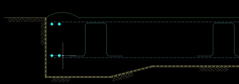

G'day,
We have recently been taken over by a new company, we are now using AutoCAD 2009 before using AutoCAD 2006 with custom cad designed by a software guru, who is know not with us.
We use to have this great Dirt / Soil LISP that would follow a line with Nearest sticky and draw in the Dirt as a hatch (using Earth hatch) at any length you wanted, and also to scale (picture attached).
Now we have StrucPLUS AutoCAD package and it has a pretty ordinary Dirt / Soil Block which does scale but only comes as the Block size and you can't stretch it or anything unless you explode it (ugh lines!).
Just wondering if anyone out there has a Dirt / Soil LISP like I explained ?
Cheers!

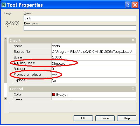

Try making a block of the earth hatch (at the size/angle you would like to see it plotted); then drag it to a Toolpalette. In the properties of the new 'tool' you can have it inserted at an 'Auxiliary scale' (Dimscale, Plot scale) and also have it 'Prompt for rotation' (2 points).
That only gives you a certain size of the block though ?
Like once you make it that size (as in length along the line) it is that same size everytime you insert it ?
I like to make them all different to give a not so perfect look about the drawings :)

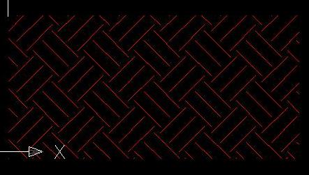

im pick 1st point end & 2nd point nea hatch is genrete cross
dear sir
very good lisp
thx for sharing
but one problem in lisp

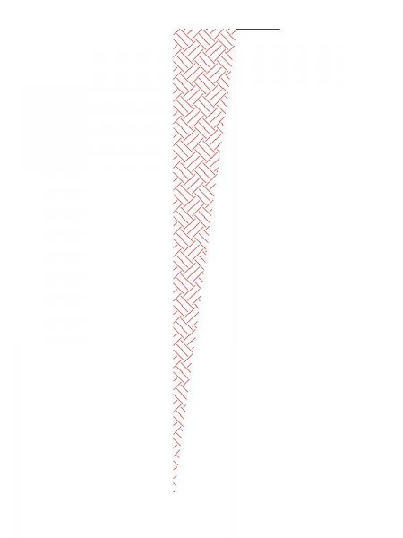

Nothing wrong on my end, The code only creates an Earth hatch like the one below.
Nothing wrong on my end, The code only create an Earth hatch like the one below.
Command: earth
Specify hatch width. : 50
Specify hatch scale. : 50
Specify hatch angle. :
Specify first point:
Specify second point: nea to
EARTH.lsp has completed successfully and will now restore your settings.
[ATTACH]22111[/ATTACH]
Command: earth

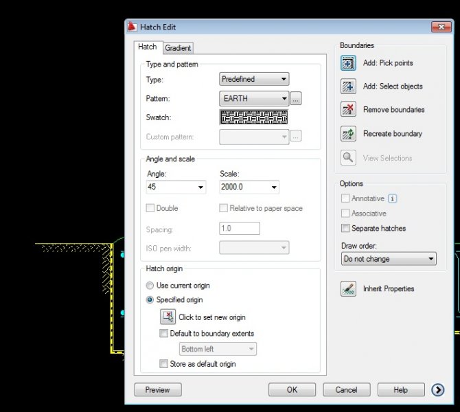

I just tested with the same values you were using and did not get a problem. I am not sure how you are getting that.
Ok, I see whats going on now. You went from an extremely large hatch setting and switched back to a much smaller setting.
I am not sure what to do about that since it also happens when you manually run the hatch command. If the drawing is closed out
and then restarted, All seems to work again. Why you would want to go from one extreme to another is beyond me.
