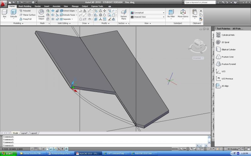

cpascual Posted July 29, 2010 Author Posted July 29, 2010 I did what you guys told me but I am still having trouble completing this part (shown). So I got the arcs oriented how I want, then I tried using the LOFT command, but using them as a guide doesn't work, and using it as a path doesn't make it turn out the way I want to either. Is there another way I can form a solid in the shape of those arcs. I had tried it with two solids earlier today but was not getting the results I wanted so I moved on to trying a loft, but that doesn't seem to be working either. Any advice would be greatly appreciated. Thanks. Quote
ReMark Posted July 29, 2010 Posted July 29, 2010 It looks like the two arcs are wider at one end (the right) than the other. Is that correct? Quote
cpascual Posted July 29, 2010 Author Posted July 29, 2010 From the picture it does look like that, but that is not the case. The two arcs are a constant distant apart from start to finish. Quote
ReMark Posted July 29, 2010 Posted July 29, 2010 If that is the case then why not create a triangle (with one side being an arc) and extrude it? Quote
cpascual Posted July 29, 2010 Author Posted July 29, 2010 Sweet. It worked. All I had to do was change the extrusion a bit to account for the angle. Thanks for the help man. Quote
ReMark Posted July 29, 2010 Posted July 29, 2010 It was just another lucky guess. Glad to see you got it finally figured out. Quote

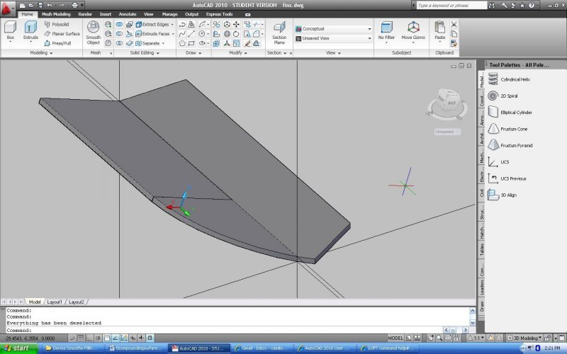

cpascual Posted July 29, 2010 Author Posted July 29, 2010 I actually had to redo it again. I still had the same problem in that last picture I showed from when I just tried doing it by combining two solids. What I ended up doing was reorienting the UCS to get the angle and do sketches on both sides and then use the LOFT command to get the correct extrusion. It finally worked out the way I wanted. Thanks for the help again. Quote
JD Mather Posted July 29, 2010 Posted July 29, 2010 I don't think if done correctly you would see a line between those two faces on left side (in your image). Attach the dwg here (preferably before you made the feature - you did save the wires on a hidden layer, right delobj=0) Quote

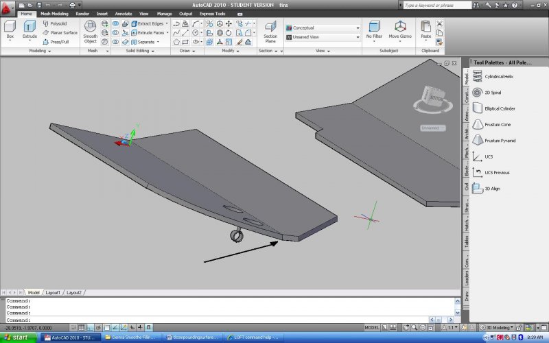

cpascual Posted July 30, 2010 Author Posted July 30, 2010 Well it doesn't have a line between the two faces on the left side anymore because I fixed the part. The arrow points to where I was having the issue. If I just had a sketch of the bottom surface of the bent side when I would extrude it it would leave a little triangle space at where the arrow is pointing. So what I had to do was sketch out the top and bottom surface and then perform a LOFT to get the results I wanted. Thanks for the help earlier. Quote
