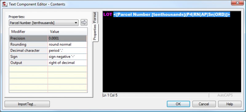

It can be done, but it's amazingly counter-intuitive...
1) Create an Expression in Parcel -> Label Styles -> Area that divides your Parcel Number by 10000 and returns the result as a double.
2) In your Area Label Style, in the text component editor, add your new value. For formatting, tell it to format to four decimal places, then for "Output", select "Right of decimal". (See attached image.)
