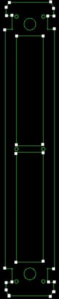

Kenter Posted July 21, 2010 Posted July 21, 2010 I made a polyline in LISP and want to add to the program so it will automatically fillet that polyline without asking the user to click on the one they want. I know you can use ssget, and have it aquire the last object made or something like that. And i know the fillet will hit every corner on the polyline as soon as you click the polyline. I am unsure how to do it though. I looked at the help and it didn't clear it up for me. I have a few polylines on the page so a select all wont work. Any idea's welcome. Quote
jammie Posted July 21, 2010 Posted July 21, 2010 Hi Is it a constant radius at each corner? Also is it at each corner that needs a fillet? Quote
alanjt Posted July 21, 2010 Posted July 21, 2010 You should really post your code, to remove all confusion. So, you are wanting to draw an LWPolyline and have each vertex filleted with a specified radius or are you wanting to fillet a drawn LWPolyline with something else? Quote
Kenter Posted July 21, 2010 Author Posted July 21, 2010 I have a very long code. However all I need is a way to fillet a polyline I have already created using LISP. All the corners will have a 0.03 fillet. Here is the code to take a look. You must have two layers created 'plate' 'x-laser' or else nothing will happen. It makes one piece off to the right side which is a wall mount and only the polyline outside and two inner boxes will be filleted. BoxPlate90.LSPFetching info... Quote
alanjt Posted July 21, 2010 Posted July 21, 2010 Here, I did this as an example, so you can follow suite from it. (defun c:PF (/ pt eLast ent) ;; Alan J. Thompson, 07.21.10 (setvar 'filletrad (cond ((getdist (strcat "\nSpecify fillet radius <" (rtos (getvar 'filletrad)) ">: "))) ((getvar 'filletrad)) ) ) (if (setq pt (getpoint "\nSpecify start point: ")) (progn (setq eLast (entlast)) (command "_.pline" "_non" pt) (while (= 1 (logand (getvar 'cmdactive) 1)) (princ "\nSpecify next point: ") (command PAUSE) ) (or (equal eLast (setq ent (entlast))) (command "_.fillet" "_P" ent) ) ) ) (princ) ) 1 Quote

Kenter Posted July 22, 2010 Author Posted July 22, 2010 Thank you all, I have gone through and made changes from you suggestions. Figured out the fillet thing as well. (command "_.fillet" "_r" 0.03 "_.fillet" "_polyline" b1 "_.fillet" "_polyline" b2 "_.fillet" "_polyline" b6 "_.fillet" "_polyline" b9 "_.fillet" "_polyline" (mapcar '+ pLL (list 10.941 2.5 0)) "_.fillet" "_polyline" (mapcar '+ pUL (list 10.941 -2.5 0)) ) Quote
