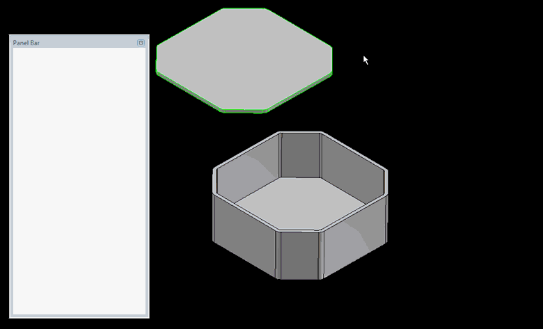

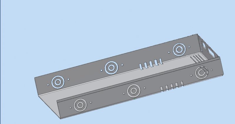

nikhil Posted July 19, 2010 Posted July 19, 2010 hi..can anyone help me with this...i need to join these two parts...the part2 should fit on part...pls help me out....how to do it ? i am not able to attach the zip file..since its of 500kb even after zip....any other way to attach it.. Quote
kencaz Posted July 19, 2010 Posted July 19, 2010 Are these 2 separate .ipt files? If so you'll need to create an assembly file .iam and constrain the parts. KC Quote
nikhil Posted July 20, 2010 Author Posted July 20, 2010 hi kencaz...thanks for replying...ya these are two different .ipt files...can u tell me how to create an assembly and constrain the parts...i am new to this software and just started to learn it..it would be a great help Quote
kencaz Posted July 20, 2010 Posted July 20, 2010 Open a new Assembly, (.iam) and use "Place Components" and import both your Part, (.ipt) files. Now use the constraint option from your browser, (your probably using the ribbon so it may be different), and add a couple of mate constraints on the edges of the lid to attach. you'll need a minimum of two constraints to get it lined up properly. KC Quote

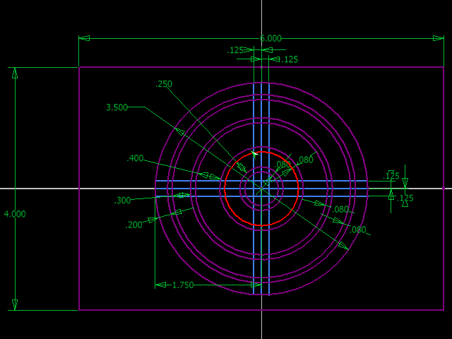

kencaz Posted July 20, 2010 Posted July 20, 2010 In your original post screenshot it looks like you have some grills for ventilation? If this is a sheet metal part that is stamped it would just leave a big hole. Try adding some ribs and spares to hold the inner islands. I believe Inventor 2010 and above has a "Grill" feature but I have not used it. You can also do them manually, however... Good Luck KC Quote

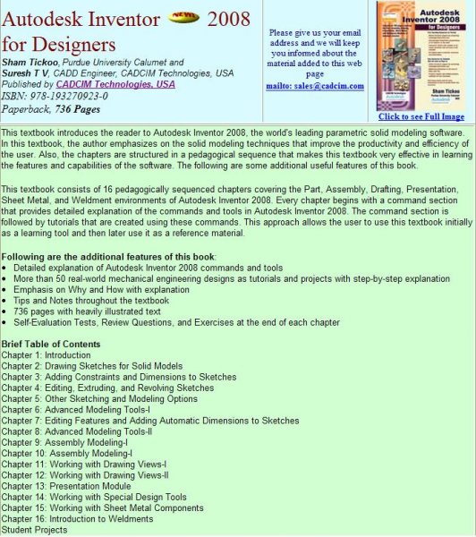

nikhil Posted July 23, 2010 Author Posted July 23, 2010 thanks alot for the help Be_cool......i did try finding some free pdf's and ebooks but cudnt get much info...if i need to buy some book for it which book should i go for...i am using inventor 2008...once again thanks for replying Quote
Be_cool Posted July 23, 2010 Posted July 23, 2010 I think that u have to consult J.D. for book advice, but my opinion is that u can find great books on h...p://ww.cadcim.com. And this is the good 1, with many examples! Quote

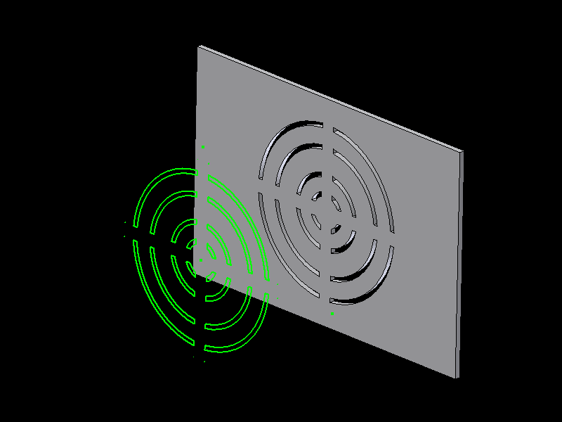

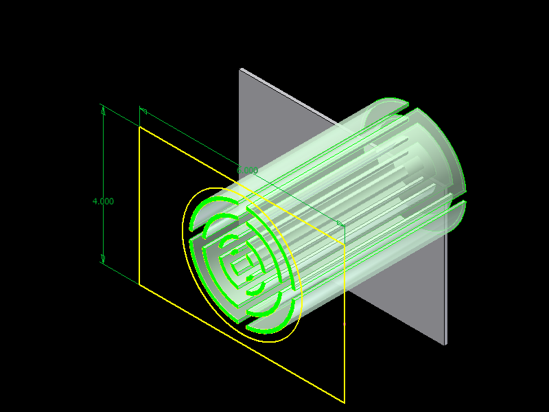

kencaz Posted July 24, 2010 Posted July 24, 2010 hi kencaz...thanks for replying and helping again...ya their are some grills for ventilation and it is a sheet metal part...i dint get u on ribs and spare on how to add them...also i am using inventor 2008....do u know about any site for downloading full tutorials or ebooks or the newer version of inventor because i guess i do need to go through them,cant keep on asking questions again and again.....once again thanks for the visual...it really helped alot to understand. Here is a simple grill you can extrude cut. you can make any shape you want. Here I just offset a few circles and lines then trimmed them up to extrude. Good Luck KC Quote
nikhil Posted July 26, 2010 Author Posted July 26, 2010 thanks bro this was really helpfull...i actually wanted to make this type of cut...thanks Quote

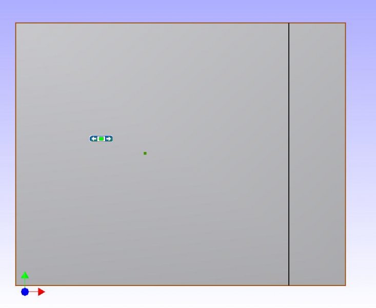

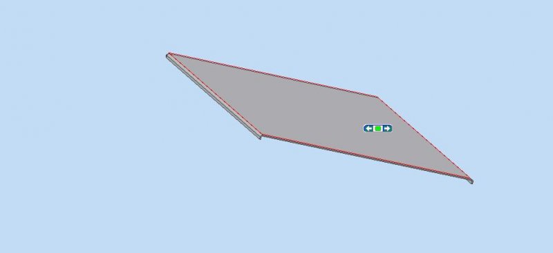

nikhil Posted July 27, 2010 Author Posted July 27, 2010 hi..can anyone help me with this...i need to bend this plate along the black line...but i am not able to do it....i dont want to create flanges....just the bend and that to 90 degrees....can anyone help me on how to do this Quote
JD Mather Posted July 27, 2010 Posted July 27, 2010 Shouldn't this be a new thread? Why didn't you attach the ipt? Why not use Contoured Flange - much easier than Bend Part or Fold Part? Quote
