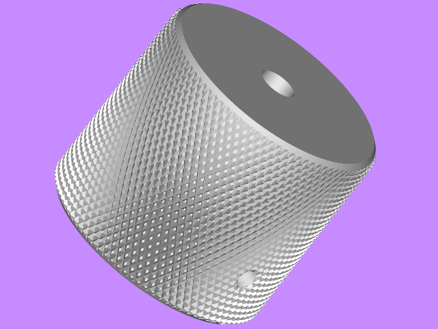

Here's a Knurl I created by first using the helix LISP routine Here:
http://www.cadtutor.net/forum/archive/index.php/t-1396.html
to generate a 30 degree-angle path just above the surface of the cylinder and then extruding a small (cutting) equalateral triangle along the path.
A polar array was then created every 4 degrees of this extrusion (creating 90 triangle helix solids) and then subtracted from the cylinder.
To complete the diamond knurling pattern, the procedure was duplicated in the opposite direction. It takes a little time to do it but in the end it does look nice:
