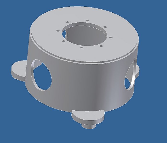

gargoyle27 Posted July 13, 2010 Posted July 13, 2010 i need to notate on an idw the length around a pipe (not linear length) from one leg to another and, from one hole to another, is there a way to do that? i also can't get it to snap to the centre of the hole anyway, is there something i can do about that? Quote

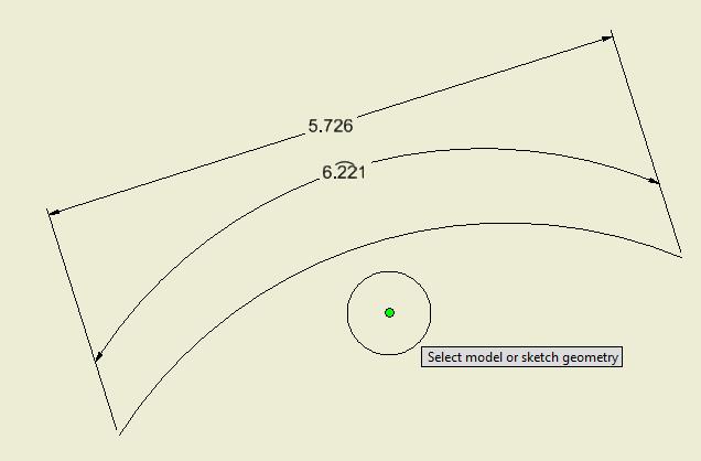

jdits7 Posted July 13, 2010 Posted July 13, 2010 Not sure which version you are running but if you start with the dimension command and select the arc and then right click you have the option to either have arc length or loop length under the dimension type. Also to dimension to the center of a circle hover over the circle and the proceed to the center point of the circle and a green dot will appear that you can select. I am including a picture to show all three of these examples. Quote
gargoyle27 Posted July 13, 2010 Author Posted July 13, 2010 they are holes thru the pipe, so all you see is the cross section, but the dimension is around the pipe from the center of the hole to the feet, so i need that view to measure it here is a picture Quote
pinco pallino Posted July 14, 2010 Posted July 14, 2010 It seems that you are trying to find the flat distance from the hole to the foot axis. I would consider a flat pattern on sheet metal. Quote
gargoyle27 Posted July 14, 2010 Author Posted July 14, 2010 its pipe tho, not rolled sheet metal it might seem silly that i want a dimension like this, but this is what the welder wants Quote
kencaz Posted July 14, 2010 Posted July 14, 2010 It's easy to get the distance. Find the circumference and divide by number of holes. I can see why he wants the dimension, however, that is pretty easy stuff and a welder should know how to find the distance. KC Quote
gargoyle27 Posted July 14, 2010 Author Posted July 14, 2010 i know, i could even just put a note "evenly spaced" or something to that effect, but he wants it as an actual dimension but i fiddled with the draft view and got it to work (or something that will work just as well) thanks for all the help Quote
pinco pallino Posted July 15, 2010 Posted July 15, 2010 ..that is pretty easy stuff and a welder should know how to find the distance. I agree. An easy lay-out is proper workmanship. Your welder should learn how to do it right, rather then you adapting the drawing with wrong dimensioning. Quote

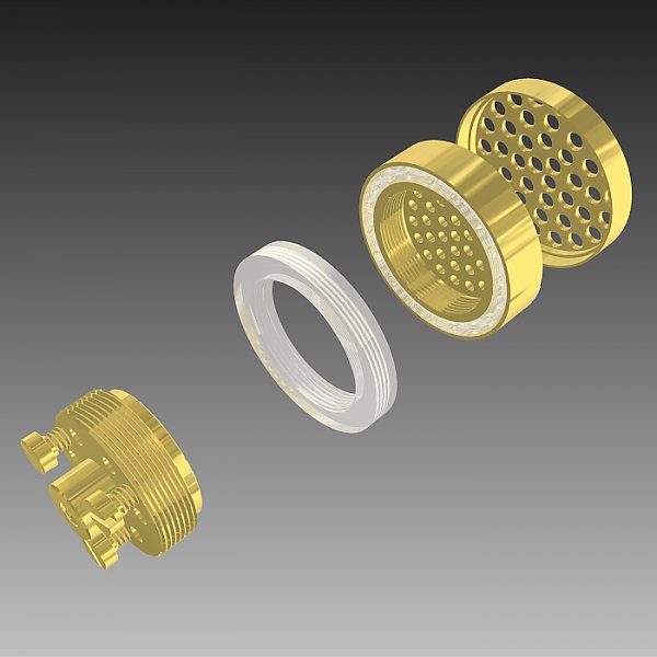

gargoyle27 Posted July 15, 2010 Author Posted July 15, 2010 I still couldn't get the actual arc function to work, so i just replaced the degree measurement with the arc length, cheating sure, but it looks just fine on the drawing which is what matters most and also, sometimes it doesn't matter what makes the most sense or is easiest, sometimes you just do what your told on a side note, looks like i will actually be cutting threads on some pieces instead of using the thread tool, at least until it becomes more obvious how much it slows down the use of the full assemblies Quote
Hopinc Posted July 15, 2010 Posted July 15, 2010 Hi Gargoyle27, Unless you have quite a large number of thread cut parts I doubt you will see much difference in speed. Attached is a very small example of an assembly of a condenser microphone capsule that I created some time back. As the threads on the capsule itself, the perspex locking ring and slug are all 40 TPI Brass Thread, plus the adjusting screws are 10 B.A., I had to cut these myself. I don't suppose it's something I would want to do for every screw thread but it does look good. Generally speaking I don't mind the simulated thread look, but on these small parts it was just not right. If your boss is wanting to impress a customer with photo-realistic images or you haven't the time/inclination to add a new thread database then it has it uses. Dave Quote

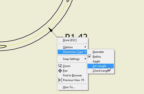

MarkFlayler Posted July 15, 2010 Posted July 15, 2010 Is this what you were looking for? I created some Work Axis and Work Points off those Axis to align your sketch better. In the drawing I used "Get Model Sketches" by RMB on the part in the tree and then just used the Dimension command and switched to Arc. Quote
Hopinc Posted July 15, 2010 Posted July 15, 2010 That's what I was trying to do Mark, but I am not sure about the original poster. I had gone several stages further and created the arc you see on the drawing plane by using f7, projecting the cut edges and adding a little sketch geometry. That's as far as I got as I could not find this arc dimensioning function. BTW - "I created some Work Axis and Work Points off those Axis to align your sketch better." - I had removed all unnecessary geometry and your actions should not have been necessary. And yes, your dimension is correct, although I was reading mine in metric at 44.975mm by dint of the measure command. OK, I have got to the stage of applying the dimension as you have above, now using the annotate menu -where is this ARC selection in the dimension function?? Dave Quote
MarkFlayler Posted July 15, 2010 Posted July 15, 2010 Start Dimension command, select the arc, then RMB before placing it. Select Arc Length Quote
Hopinc Posted July 15, 2010 Posted July 15, 2010 Sorry Mark, those options do NOT appear in the RMB menu. Everything else does, but not the dimension type. I suspect the original poster is seeing exactly what I am seeing. I also suspect you were thinking we are a bit dumb and that it should be obvious :-) What version are you using? Dave Quote
MarkFlayler Posted July 15, 2010 Posted July 15, 2010 Are you getting the radius to appear first? If you get a green dot, then you won't get an option for this. Quote
JD Mather Posted July 15, 2010 Posted July 15, 2010 Do not pick the endpoints of the arc - select the arc itself when dimensioning, then RMB.... Quote
