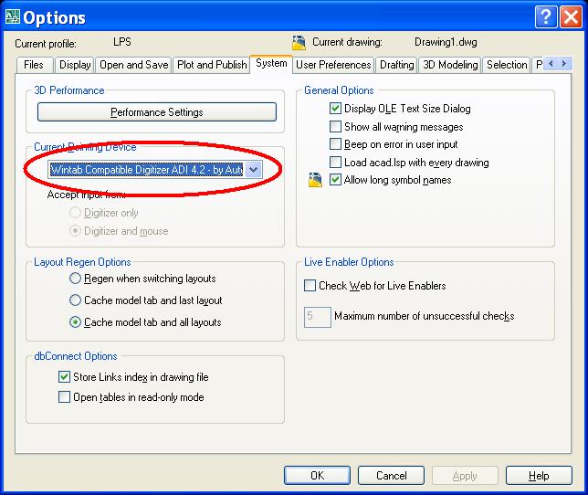

Whenever i try to calibrate the tablet it says, "your pointing device cannot be used as a tablet" ??
Check Options > System
Is your 'Current Pointing Device' similar to this? It should be in order to use your tablet to digitize. If it's 'Current System Pointing Device', that's probably your problem.
Your help is awesome thanks, one final problem; when i digitise the detail of the map now if i have to move the main working screen, e.g. scroll up or down, side to side, when i place the puck back on the screen it is obviously in the wrong location. Is there any way round this or is just a case of being more zoomed out at the start of the digitising process.
Did you calibrate the tablet - assign coordinates to points on the digitizer? It's been awhile since I used a tablet; gave it up for a mouse when I learned to insert images.
IIRC you can't zoom, pan with the tablet on (toggle with F4).
Tablet on > digitize
Tablet off > zoom, pan, menus etc.
