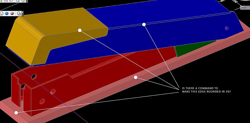

is there a command to make the edges in 3d solids become rounded
Yes. The command is called Fillet.

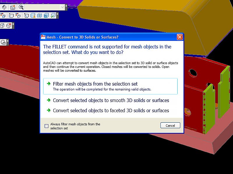

thank you for the input but autocad's reply is: it is stated there that fillet command is not supported, could pls somebody help !
Why are you using Mesh for simple geometry?
Convert to solids.

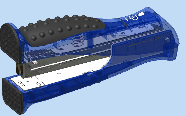

Here is pic of stapler I did in Inventor
sir, the stapler is very beautiful, I can also do that in 3dmax the same, but it lacks dimensioning for production, can that inventor be importable in autocad so to be as plan? like front view, top view,
side view, etc. Maybe there will be steep learning curve in inventor
.. can also do that in 3dmax the
3DMax is for pretty pictures - not product design.
Inventor is far easier to learn than AutoCAD, but AutoCAD is capable of the design you did, you simply need to use the solids tools in AutoCAD.
I agree with JD Mather, just convert your meshes to solids and aply the fillet tool!
