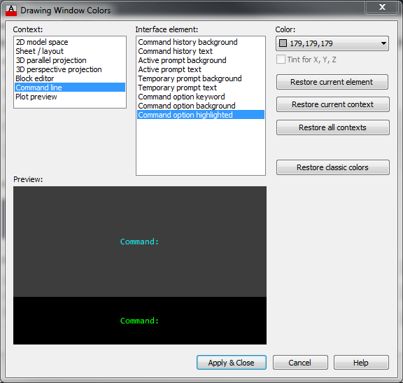

TheyCallMeJohn Posted June 14, 2013 Share Posted June 14, 2013 Does anyone know how to do this for later versions. I changed the color of my backgrounds to make it a little easier to read now I can't see the cursor. I don't see any options referencing cursors or pointers. Quote Link to comment Share on other sites More sharing options...
ReMark Posted June 14, 2013 Share Posted June 14, 2013 If you don't have 2D Model Space highlighted how do you expect to change the color of your cursor? Certainly not by highlighting Command Line like you show in your image. Quote Link to comment Share on other sites More sharing options...
SLW210 Posted June 14, 2013 Share Posted June 14, 2013 Yes, you need to be in 2D, Sheet/Layout, and the 3D for cursors (aka crosshairs). Quote Link to comment Share on other sites More sharing options...
