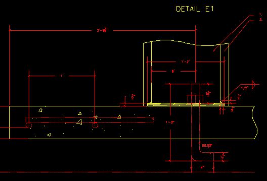

If you read the text above that 'callout' it tells you-
So- (2) 1-1/2″ Ø × 18″ STD. AB. W/3-1/2″ PROJ.
(2) two off
1-1/2″ Ø 1-1/2" diameter
x 18″ 18" long
STD. AB. standard anchor bolt
W/3-1/2″ PROJ. with 3-1/2" projecting
The 'callout' is just shorthand to save writing long notes on the drawing.
The abbreviations used are standard, but can change from industry to industry and from country to country.
You soon get used to using them and once you realise its shorthand you can usually guess the meaning of any new ones you come across.
This is corect, there is also a 4'' bend at a 90 degree angle. So the AB (18") - Projection (3.5") = 14.5 imbeded in the concrete. With 3.5 inchs above the the base plate.
Detail E-1 will show this
