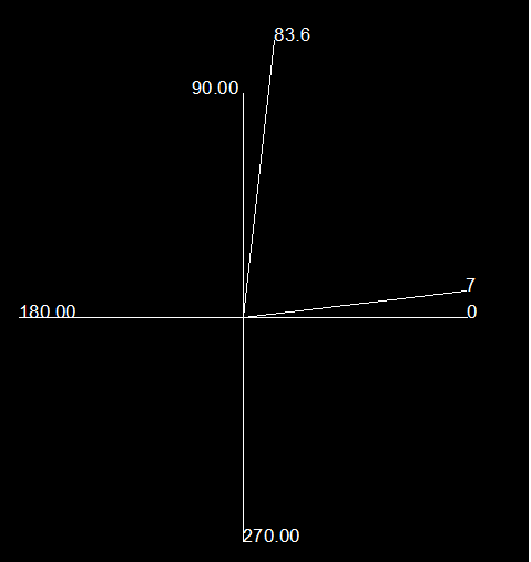

My code is almost done but i am stuck at the end. I am supposed to show directions and have been provided with the value of u and v.
Using atan(v/u) i get the value of theta.
But the problem that i guess is that by default the unit is set to East anticlockwise. So if i have to plot 83° it appears like 7°. Because it shows 0 in the East.If i change units to north clockwise, it doesn't makes a difference only if i plot in manually but no difference if i try to plot it via VBA.
Is there a way or some setting so that I can make 0° North clockwise as default
Please find the attached image.

I think that the system variables ANGBASE (set to 90) and ANGDIR (set to 1) are what you are looking for. Please don't forget that those are saved in drawing.

It didn't help :(. I tried making angbase 0 but its still the same.
Sorry I forgot to paste the code in my previous thread. Is there something wrong with the code ?!

Since you want North to be the 0 angle should set ANGBASE to 90, not to 0. I think the below example is what you need to use:
ThisDrawing.SetVariable "ANGBASE", 90
ThisDrawing.SetVariable "ANGDIR", 1

Still no luck.. It is still creating line at 90° north when theta = 0 even after including the above code. Do i still need to add more lines of code to it.
When i manually change the drawing unit angles and manually create a line with command like @10
