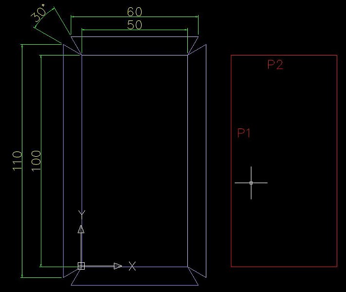

Thank you for being courteous. here is an image of what i need. the red one will overlay the purple one. I would like to be able to give a length and width of the red one, (p1 and p2) as well as a starting point. Then it will draw out the rest.
start on layer 'plate' (red)
global width of 0.0625
starting point
enter length
enter width
draw red
switch to layer x-laser (purple)
global width of 0.04
redraw red
then use a formula to draw the outer shape.
I am not sure if it is easier to offset, then make a generic 30 degree corner that gets mirrored around to each corner and then trim, or to just command a line that will have logic on where to draw the shape. any help is appreciated.
Guest lesliematt
it will also promt the user as tothe depth of the box. ergo the flaps on the purple one will be dependant on the user.

This is a good start, and some ppl have helped me get this far. now im stuck tho
Hi
What do you mean by the global width ... ????? And at the same time you what the program to ask the user to insert the width also.
You would better also give the offset distance for the purple rectangle
(from red one to outside pose gap distance).
Regards
Tharwat

the offset distance on that specific one is 10". what i mean by global width is the thickness of the red box needs to be 0.0625, and the thickness of the purple one is 0.04. in properties, it is called global width.

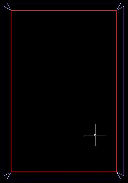

wow, that is incredible. how do i change it so both will be in line with each other. ergo one directly ontop of the other?
The code currently creates three poly's - the red one, and two purple (one of which is identical to the red one, but of a different pline width), are you saying you want the red on on top of the purple one? - I just followed your pic :)
Guest lesliematt
I no you just followed the pic, lol. It works perfect. but i actually needed them inline with each other, so the red one is directly over the purple.

Ok, no worries.
About a year and a half I think.
Try this:

Perfect. Wow, you are impressive. does it have to be:
'pick first point'
'pick second point'
or can it be
'pick first point'
'enter length'
'enter width'
or does that change everything??
Thanks :)
It could of course be done, but I thought that as it stands it is better as the first pick doesn't have to be the lower left corner (or another fixed point) but rather can be any corner. Plus you should be able to enter the length and width as relative coordinates as it stands.

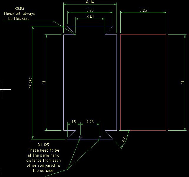

I also need one that will function in the same way, but make something that looks more like this. I really appreciate all the help if you can.
need.dwg
Bear in mind that my time is voluntary - I am not getting paid here.
Guest lesliematt
I do realize that Lee Mac, and i am extremely grateful. If you can help, there is no deadline. and it would be appreciated. I am trying to figure it out, but I am not really good at this stuff. Let me know what you think of this one. it doesn't need that much modification since its along the same lines.
Was bored this evening, this is as far as I'm going with this one.

 (if (and (setq p1 (getpoint  "\nSpecify First Corner:  "))
          (setq p2 (getcorner "\nSpecify Second Corner: " p1))
          (setq fl (getdist   "\nSpecify Depth: " p1)))
     (setq undo (not (vla-StartUndoMark doc)))
     (setq norm (trans '(0. 0. 1.) 1 0 t))
     (mapcar 'set '( p1 p2 )
       (mapcar
        '(lambda ( foo )
           (apply 'mapcar (cons foo (list p1 p2)))
        '(min max)
     (setq bbox
         (lambda ( data )
           (mapcar
            '(lambda ( funcs )
               (mapcar
                '(lambda ( func )
                   ((eval func) data)
                funcs
            '((caar   cadar) (caadr  cadar)
              (caadr cadadr) (caar  cadadr))
         (mapcar '(lambda ( p ) (trans p 1 norm)) (list p1 p2))
     (LWPoly
       (list
         (car   bbox)
         (polar (car    bbox) 0. (/ fl (tan (* pi (/ 47. 180.)))))
         (polar (car    bbox) (/ (* 3. pi) 2.) fl)
         (polar (cadr   bbox) (/ (* 3. pi) 2.) fl)
         (polar (cadr   bbox) pi (/ fl (tan (* pi (/ 47. 180.)))))
         (cadr  bbox)
         (caddr bbox)
         (polar (caddr  bbox) pi (/ fl (tan (* pi (/ 47. 180.)))))
         (polar (caddr  bbox) (/ pi 2.) fl)
         (polar (cadddr bbox) (/ pi 2.) fl)
         (polar (cadddr bbox) 0  (/ fl (tan (* pi (/ 47. 180.)))))
         (cadddr bbox)
       1 lay2 0.04
     (LWPoly bbox 1 lay1 0.04)
     (setq undo (vla-EndUndoMark doc))
