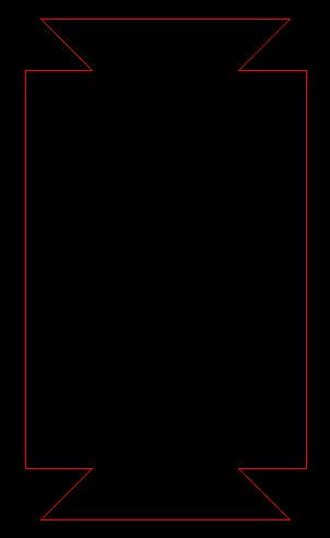

I am working on a lisp will start a polyline at coordinates that i choose. then it will automatically go in the direction of 90 degrees, input a distance, it automatically goes to 0 degrees, and again enter a distance, and then it will automatically finish the box.
so pretty much i want a program that will make a polyline box starting at a user specified location, and all i will have to input is a length and a width and it will make it. i need it to be a polyline and not a rectangle because i need to specify a global width. if there is an easier way, please help. lol

actually i realized i could make it with a rectangle and then us pedit to change it to a polyline.
Guest lesliematt
C:\Users\mleslie\Desktop\Project Polyline\block.jpg
I need to figure out how to make a poly line that will force angles, and all the user needs to do is put in lengths to make an object like this ^
Its not that hard to make , you need to know the varies lengths of your pose and with " polar " function you can create it easily.
Regards
Tharwat

Straight out of my toolbox...

This works well. I am fairly new to using lisp tho. i will see how far i can get making the object i previously posted.
