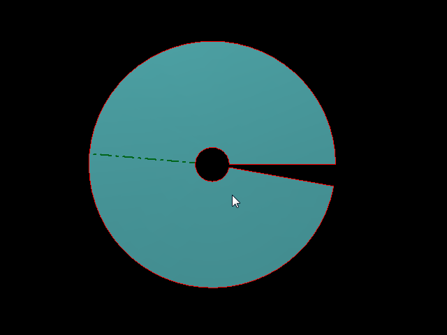

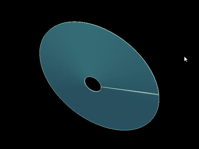

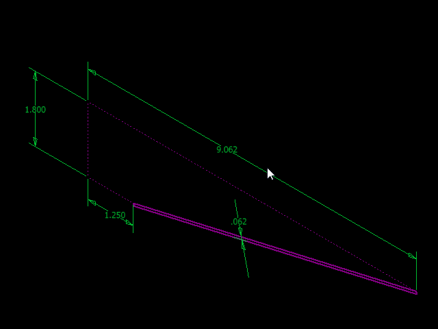

Here's what I'm trying to do....and maybe I'm going about it the wrong way...I'm trying to make a funnel with approx a 2.5" opening at the bottom and a 18.125" OD. The height is 1.8" and material thickness is 18ga. In Autocad I drew the small dia circle and another w/material offset then up 1.8" in Z I drew the 18.125" and another w/ material offset. From the front view then drew a polyline connecting everything and revolved - Voila! a funnel....I want to do this in Inventor so I can generate a sheet metal flat pattern and cut it out on our CNC plasma table.
Check this example (done in edu version so delete after inspection).
Funnel.zip
You can revolve your profile in Inventor as well:
Just revolve under 360 angle or it wont flatten.
