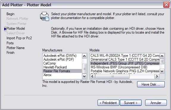

Hi,
In this case, you can create a new raster plotter
File/Plotter manager/Add-A-Plotter Wizard
step 1 - next
step 2 - my computer
step 3 - Manufacturers --> Raster File Formats
Models --> Independent JPEG Group JIFF
step 4 - next
step 5 - Plot to file
Step 6 - give a new name or not
Step 7 - finish
Bye
Pascal
