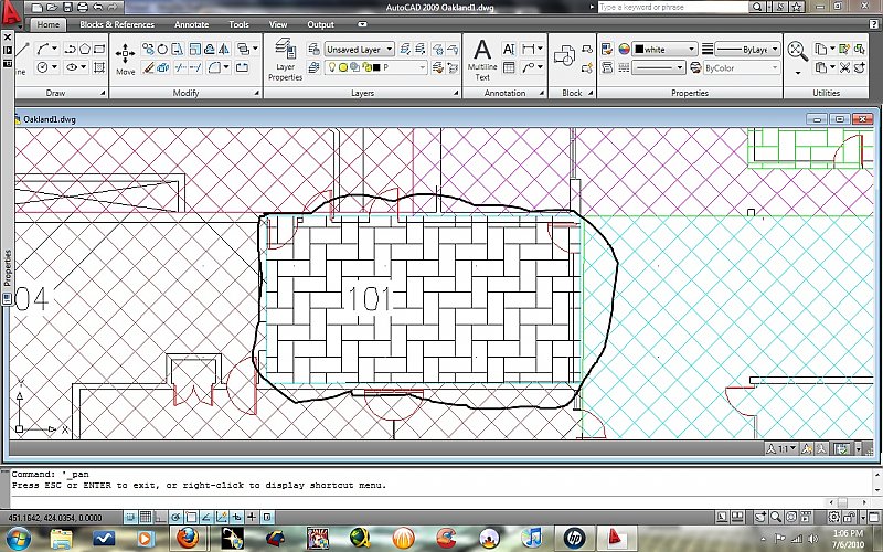

thorobred Posted July 6, 2010 Posted July 6, 2010 I'm stuck on changing a polyline into a different design, I'm posting a attachment to this post so you can see what I'm working with thx. Quote

thorobred Posted July 6, 2010 Author Posted July 6, 2010 Polyline? Looks like a Hatch to me. Can you provide a little more information about what you're trying to do? you right it is a hatch but I wanna change the polyines inside that hatch Quote
thorobred Posted July 6, 2010 Author Posted July 6, 2010 Are you referring to the hatch pattern within? Why would you be stuck? I wanna change the design to the hatch next to the left of that one Quote

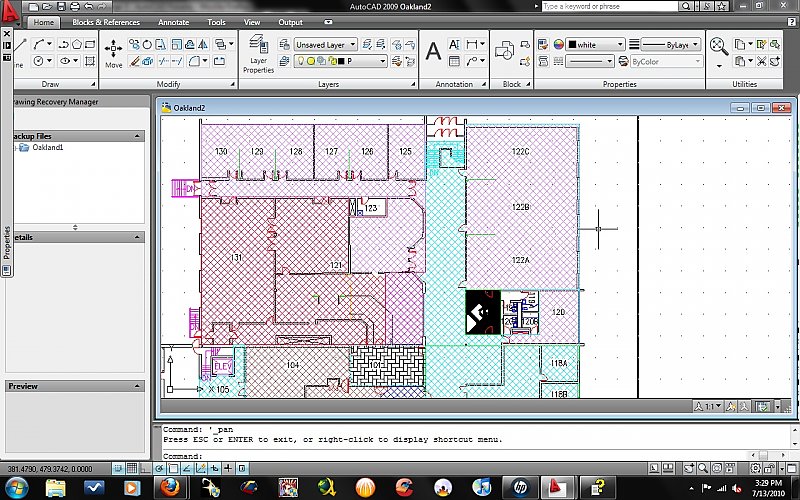

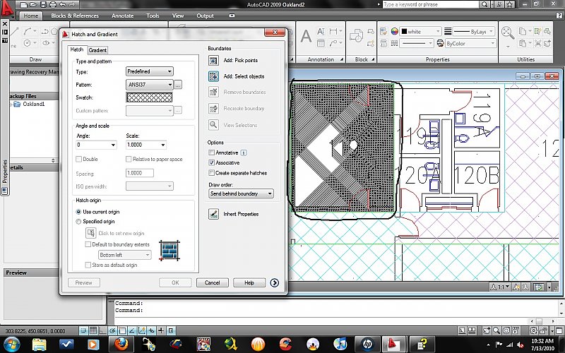

thorobred Posted July 13, 2010 Author Posted July 13, 2010 I have deleted the polylines and tried to re-hatch it, I went to hatch, selected the object and selected the area I wanted to be hatched. I picked the design and when I hit click ok, the pattern looks nothing like what I chose, is there something I am missing?? Quote
gsksun4 Posted July 13, 2010 Posted July 13, 2010 I have deleted the polylines and tried to re-hatch it, I went to hatch, selected the object and selected the area I wanted to be hatched. I picked the design and when I hit click ok, the pattern looks nothing like what I chose, is there something I am missing?? Almost sounds like the area is not totally enclosed and the hatch responds abnormally. Maybe try drawing a polyline around the area, not leaving any breaks in the line, then try hatching it. Then you could erase the polyline. I've had lots of trouble with areas that weren't completely enclosed. It's worth a shot. Quote
thorobred Posted July 13, 2010 Author Posted July 13, 2010 did you try the "inherit properties" tool? Yes, but I don't fully understand how to use it. Quote
dbroada Posted July 13, 2010 Posted July 13, 2010 Yes, but I don't fully understand how to use it.you click the tool then click on the hatch you want to duplicate. The pattern, scale and angle all then get updated to match the pattern selected. Quote
