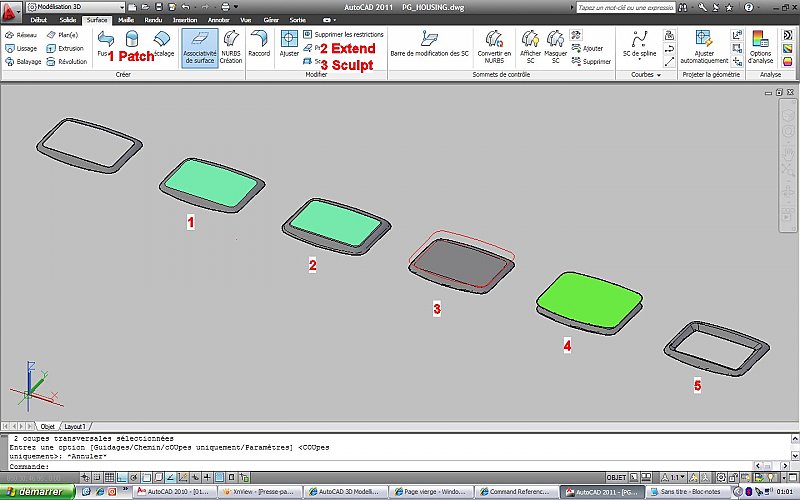

Hi Bobzy20,
I found a trick by using the new commands of tools surface.
1- Patch to create surface on top and bottom
Surface tab/Surfaces/Patch
2- Surfextend to extend surface on top an bottom because the surface of the outline has to exceed the surface of the top and the bottom to be able to use sculpt
Surface tab/Surface editing/Extend
3- Surfsculpt to create a solid
Surface tab/Surface editing/Sculpt
4- Loft to create solid to use to substract
Home tab/Modeling/Loft
5- Substract
I cant attached file because is to big see link below
http://www.cijoint.fr/cj201007/cijFUvb8Lu.zip
:) Thank you for this "brain teaser" because grace to you I saw a real application of the new commands of tools surfaces.
By hoping to have been rather explicit
Have a good day
Pascal
PS : If link dont work send me an email.
