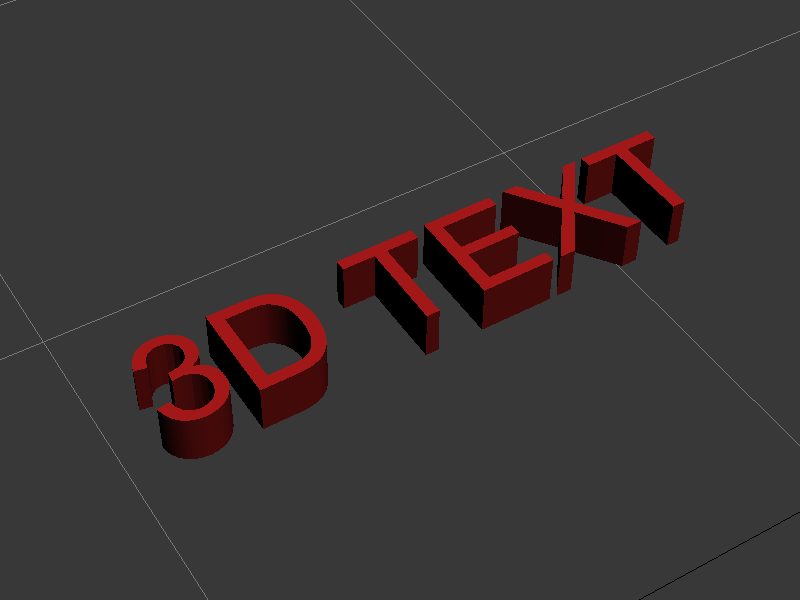

good day to all of you guys, I have a question.
Is it possible to extrude text in autocad? just like in 3d max
i've tried it but i am not happy, after exptxt, i use region command then extrude but the resulting geometry has a lot of faces on curves

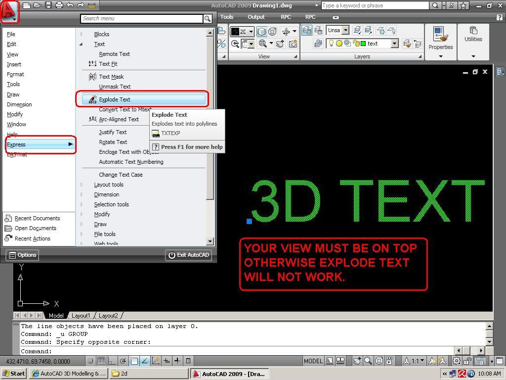

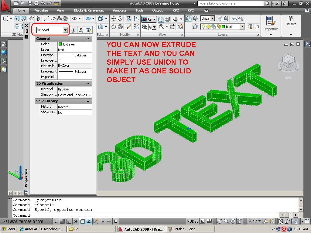

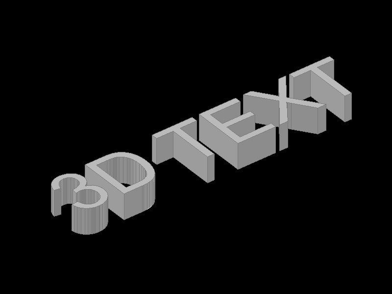

Well, you seem to have 3ds... Why not just import your .dwg into 3ds as such:
KC
This might help you
Good luck
