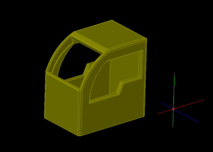

Yes, sweep would work the same way in AutoCAD. You can sweep an arc to create a surface for slicing...
They modeled it solid, however, I would probably shell it and cut the windows for a more realistic look. but it's up to you...

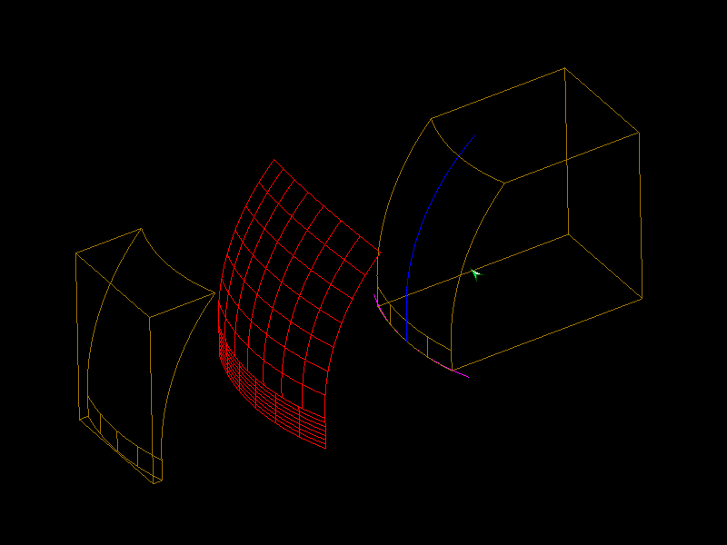

OK, you need two arcs... The first is the swept object, (Pink arc), and the sweep path, (Blue arc).
That would be "Sketch1 profile" and "Sketch2 path" from pg32 of the Tutorial.
Now as in the tutorial my path is not a full arc but has a straight vertical element. I used Pedit to join the lines for a single path. You'll probably need to re-align your USC for this...

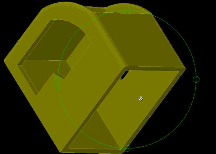

Also one other question about page 35 on the tutorial, I'm trying to draw the sketch on the side of the Cab but if I follow the tutorial measurements it looks nothing like it does in the tutorial.
I was just wondering if you could have a look for me and see what you think?
I guess if the sweep path arc has been drawn in the wrong way then this would effect this.

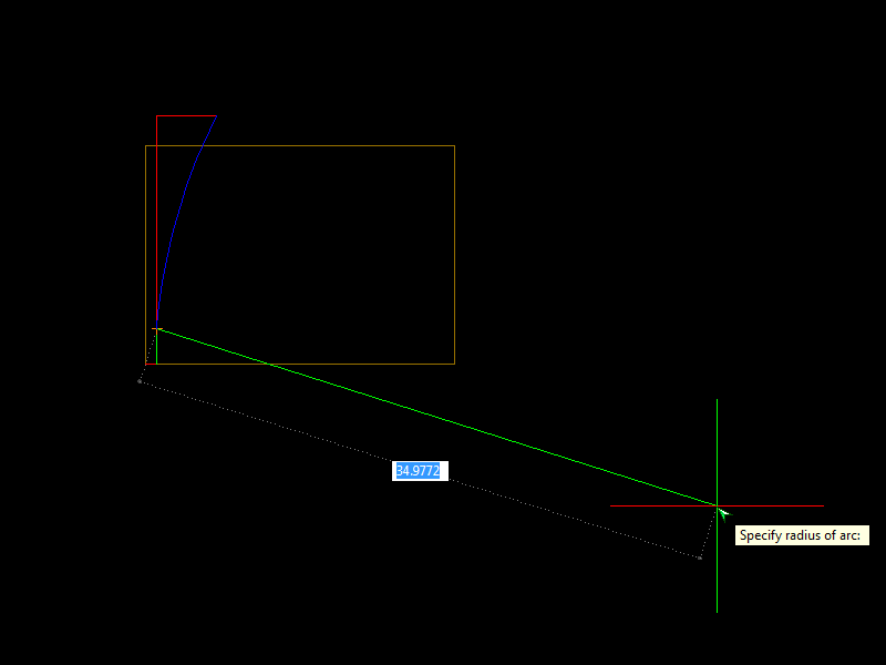

Well, yes you could use a circle with a 35 radius, the path is just longer. I prefer to trim the circle or you can draw an arc using "Start, End, Radius" as such:
I started the arc slightly up from the bottom of the cab for that vertical element as before. The red lines I only used to get start and end points for my arc. I went a little above the cab to make sure the created surface covers the solid entirely or the subtraction wont take.
Yes, then they would not be concentric...
You could use as offset of your sweep path, (3mm) in this case, however, that is from the already chamfered edge of the cab so it's probably more like (5) for your offset and use it as a start point for your window cut-out, then mirror that to both sides of the cab.
