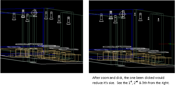

There is still question regarding the light glyphs, I've learned changing their Z position from Properties. But is it normal that they are kind of funny to catch and their size change.
As fahim suggested, post a screenshot or render so we can see what you're talking about.
After zoom and click, the one been clicked would reduce it's size. See the 1st, 2nd & 4th from the right.
The lights are in a separate Layer but the glyths cannot be switched on and off from the Layer Properties. Can only do it one by in the Light Properties > Glyth display Auto/On/Off. What is “Auto” means anyway?
Thanks.
When you zoom in or out, the light glyphs become larger or smaller as they move closer or farther from the camera, just like any other objects in your scene. But when you click on them, they shrink back to their normal size. You can perform a global resizing of all glyphs at once by simply doing a REGEN or REGENALL after zooming.
Thanks Cad64. REGEN it is.
