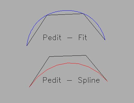

You could bring an image into AutoCAD and do your best to trace over them with a polyline then use the Spline option of the Pedit command to approximate them.
On a purely personal quest for understanding, could you please explain why you recommend the Spline option, when by doing that, the resultant curve pulls away from the pick points?
I would have used the Fit option, but I am willing to learn new techniques.
My picks using the digitizer's puck are so close together by the time I back out of the drawing (I zoom in quite close) the difference between "fit curve" and "spline" is negligible. But I do concede your excellent point.
