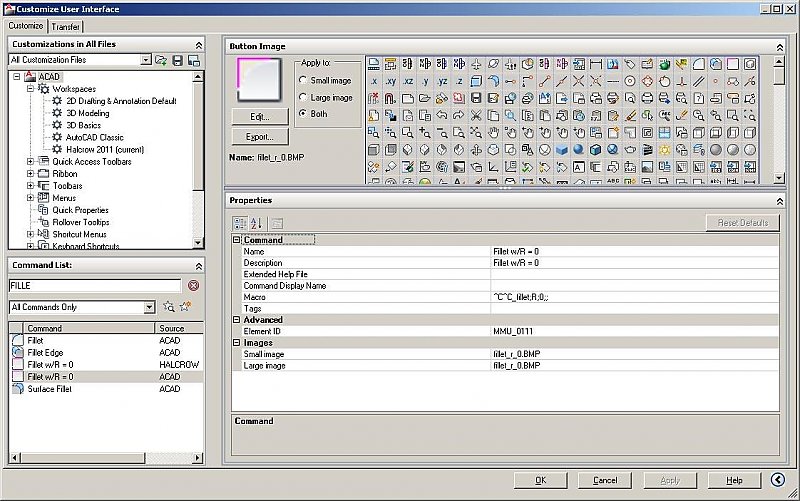

CivilPrice Posted June 30, 2010 Posted June 30, 2010 Does anyone have a fillet Radius lisp routine. so instead of typing F(fillet) R(radius) then the radius dimension, I can just type FR, and it will automatically be fillet radius and will work continuously until I exit the command. I am sure someone out there has this. Thank You! Quote
Nardino Posted June 30, 2010 Posted June 30, 2010 I don't have a lisp, but if you know how to modify the cui, you can add a new command called say .....FR...., and add this to the macro line of the cui ^C^C_fillet;R;0;; and it will work just fine Quote

CivilPrice Posted June 30, 2010 Author Posted June 30, 2010 Ok... In the CUI the command shows up, but if I type FR in the command line... nothing. So I used the command alias editor and there was a FilletRad and I set that to FR. It works but I enter a value and it exits the command. in the properties of the cui for my new fillet radius: name: fillet radius display: FR macro: ^C^C_fillet;R;0;; what did I do wrong? Quote
Tharwat Posted June 30, 2010 Posted June 30, 2010 Ok... In the CUI the command shows up, but if I type FR in the command line... nothing. So I used the command alias editor and there was a FilletRad and I set that to FR. It works but I enter a value and it exits the command. in the properties of the cui for my new fillet radius: name: fillet radius display: FR macro: ^C^C_fillet;R;0;; what did I do wrong? There is no need for tow semicolon..... That's all Enjoy Tharwat Quote
CivilPrice Posted June 30, 2010 Author Posted June 30, 2010 hmm... still doesn't work??? I enter the value... boom ends command??? maybe i approched this wrong. i dont want to set a value to fillet radius. i want a new command that is filletradius, then i type the radius, it holds that radius for multiple line until i choose to exit the command. oh i need to try they lisp Quote
Tharwat Posted June 30, 2010 Posted June 30, 2010 Please follow the steps below to get the fruits. 1- open the CUI in Autocad. 2- create a new command . 3- in the cell of macro within the command that created type the code like this c^c^_fillet;r;0; 4-Bring the command which you created to one of the menu bars of Autocad 5- Press Apply then Ok 6- Go to the menu that the command inserted to then invoke the command 7- Enjoy the command Tharwat Quote
