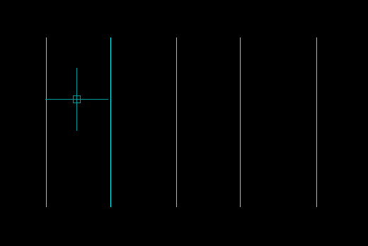

I'm not sure DimContinue will yield the exact desired results. I used no commands. I basically gave me exact procedure in an earlier post.

hi ALAN
is there any hope that you gave us the lisp ???

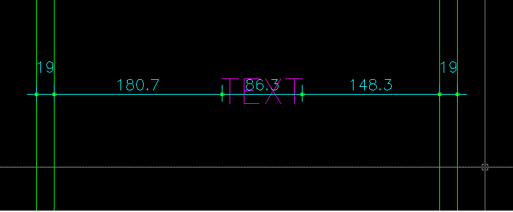

There are how to make a change in this routine does not scale TEXTs?
  scamaru said:
Lee,
First of all, thanks for the help.
I don't know what you are talking about - this routine doesn't involve 'TEXTs'
So, add an ignore of *TEXT to the ssget selection filter.
