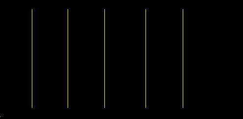

I need a routine to scale the intersection of several lines.
Can someone help me?

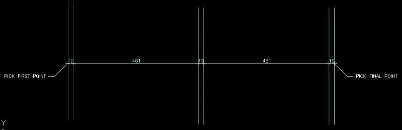

To code:
  1. Draw a line from pick point to pick point.
  2. Select all objects with ssget crossing (using two picked points)
  3. Collect coordinates using (vlax-invoke obj 'IntersectWith with each object from ssget.
  4. Draw in dimensions with collected coordinates.
Do not really know how to do this but I will search.

I did, but I'm trying to give him the opportunity to code it himself. I basically gave the procedure I used.

The QDIM command will do (quite) the same.
Regards,
MSASU,
I know QDIM and unfortunately he does not like the example posted by Alan.
QDIM creates unnecessary extension lines.
For sure it will not work on slope, only orthogonal. But you may choose the location of dimension lines and extension lines can be disabled.
