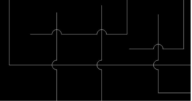

I need a lisp JUMPER all.........pls see the attachment.
I saw many routines in this forum also The swamp forum that posted by LEE and others. these all almost near of my requirement (ex. Jumper, Break all etc..).
Tips.
1.Jumper any side its ok
2.break distance or radious input required
Thanks lot
Regards
mani:)
Do you need help in writing it or do you want someone to write it for you?
are these lines or polylines?
Suggestion to start the code:
Use getreal to get radius
Use entget and entsel to pick the jumper line
Use entget and entsel to pick crossing line
Use inters to find the intersection
Use angle to get the angle of the jumper line
Use polar to get the 2 points of the arc
Use the trim command to trim out the line
This basic layout should get you going in the right direction
Hi JOHN,
I need a lisp...bcoz i am learning now, i can't write such a big task.
These all lines or polylines only.....
Thanks
mani:)
Lee's has a factor built in, you could easily change it to prompt for that size factor. And for the side the jumper resides on, you could easily have a 'on completion' prompt that asks if you want to mirror the object and easily do so if answered 'yes'.
