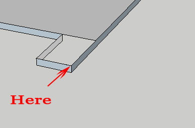

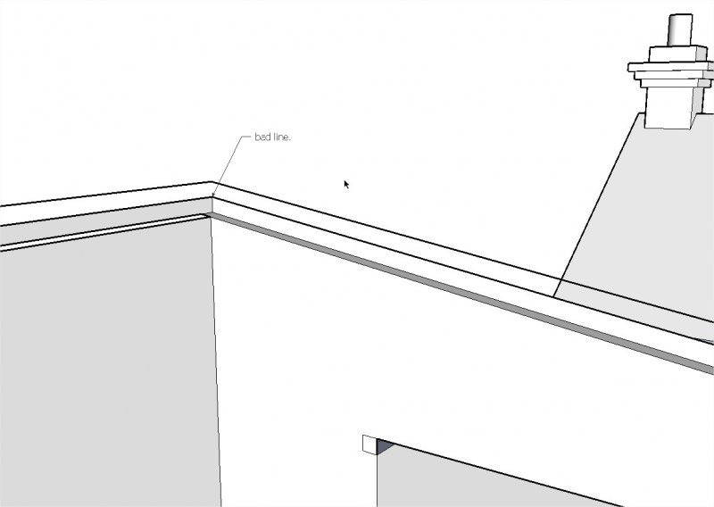

Hi Richo, I have looked over your model and I have some notes:
1. Your entire model is one piece which can cause you trouble fast. Best practice for building a SketchUp model is to make groups or components as you progress. For example, draw your floor surface then make it a group. Draw your walls then make them a group. Then start your roof... etc.
The reason for doing this is so your model is not so "sticky". Meaning that if you touch one piece of geometry it will affect the rest. Keeping geometry separate is key.
2. Your roof surface that is not filling in has a flaw at the lower corner. See first image. There is a line that is 0.1mm off. This is causing your roof to not fill in.

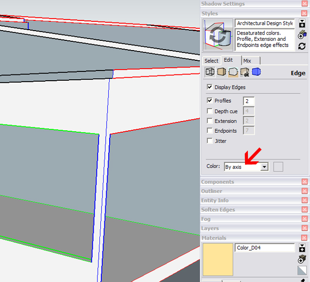

Final tip: in the second image I have attached you will see the Windows Panel (Window/Styles)
If you change your line color to "By Axis" you will be able to see which lines are following the axis and which are not. This can be very helpful if you are not getting geometry to fill in.
this is a great tip Richo! take it and run!
