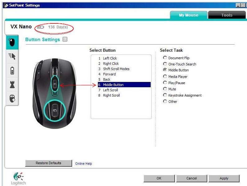

Tankman Posted June 30, 2010 Posted June 30, 2010 I do like Logitech but, the scroll wheel I don't like using for a button. I like the Logitech with both the scroll wheel and a center button. Hold the center button down 'n pan away. Top left, battery life indicator. The mouse did get a new battery 'bout a week ago, an AAA Duracel. Quote
Tankman Posted June 30, 2010 Posted June 30, 2010 thegodplato said: Its a M-RBQ124 as far as I can tell from the underneath of the mouse. I have tried the wheel as set above by Ipseifert and all that does is bring up a shortcut menu with a list of OSNAP options headed by Temp Track Point.To be honest I am using the mouse whilst in the office which is for a week in every month, the rest I'm at home using a different mouse, so maybe I just have to put up with it whilst in the office? In the office, look in your programs. Might you have the Logitech program? You'll get the screen lpseifert posted. From their set the scroll wheel to button. Quote
thegodplato Posted June 30, 2010 Author Posted June 30, 2010 I have re-installed the Logitech program as per Ipseifert's post which although does give me a similar screen shot, and I set teh scroll to middle button, I only get what I posted yesterday - IE no pan when held down, just scroll up/down, or scroll left/right. Quote
Tankman Posted June 30, 2010 Posted June 30, 2010 thegodplato said: I have re-installed the Logitech program as per Ipseifert's post which although does give me a similar screen shot, and I set teh scroll to middle button, I only get what I posted yesterday - IE no pan when held down, just scroll up/down, or scroll left/right. The scroll wheel is touchy. I find not hold down but, hold down with backward (towards the palm) push works for panning. I do like the smaller mouse with both the scroll wheel and the built in center button. Works very well. Quote

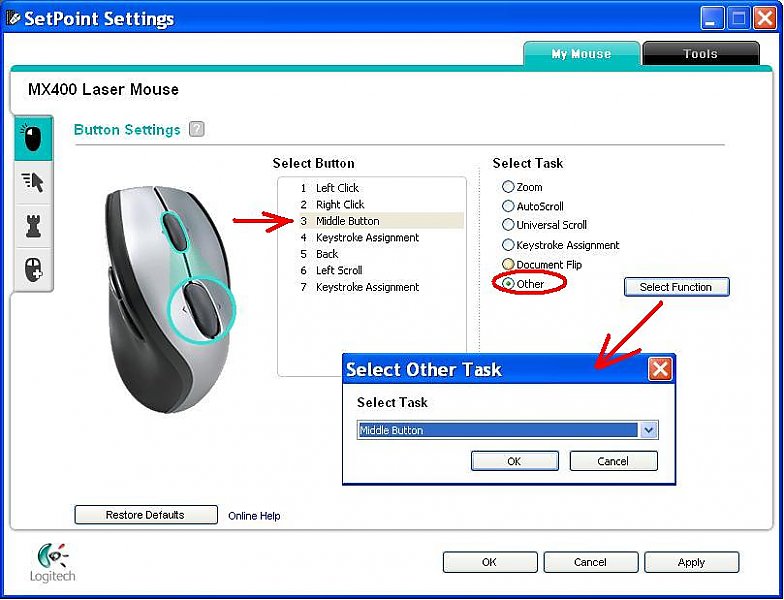

Dana W Posted June 30, 2010 Posted June 30, 2010 thegodplato said: I have re-installed the Logitech program as per Ipseifert's post which although does give me a similar screen shot, and I set teh scroll to middle button, I only get what I posted yesterday - IE no pan when held down, just scroll up/down, or scroll left/right. Did you also check Other under Select Task and then Select function = Middle Button? Without that, it still won't work. Quote
