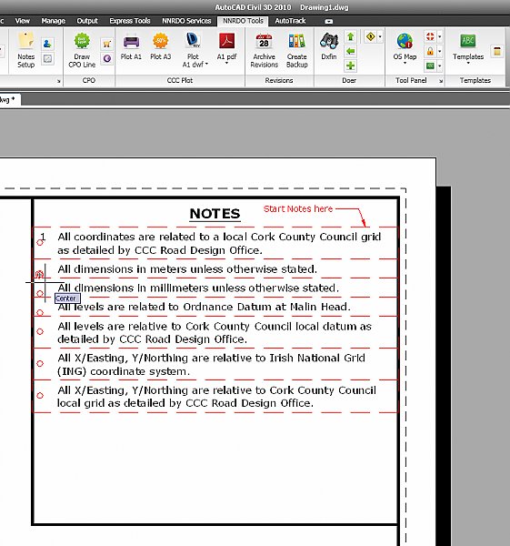

I am pieceing together a LISP that will allow users to input numbers incementally next to the notes that they can insert from a lisp. I have set it up so that it inserts the numbers on a specific layer. If someone deletes or adds a layer and wants to rerun the numbers, then the layer is deleted and a recreated and the new set of numbers created. I realise that this isn't the best way to do this in case someone has put something on that layer (even with all the warnings not to do so). I have tried to play around a with creating a selection set that will allow me then to create a block with the numbers in it.
Can someone help with the code or tell me is there a better way to do this that I am looking at?

Yeah I have that downloaded as well but I'm looking for something very simple in this case. The guys in my office tend to shy away from something with many options.
That is why I wanted to so it this way. I got this from another lisp and I think it is something along these lines only that this was selecting all the text whereas I want to select only the text I create in this lisp.
